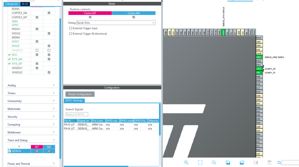

i am having a different problem, i am using dual core but when i program it and start the debugger the it says "Target is not responding, retrying...". i thing it has to do with the TRACK and DEBUG in .ioc file. can you help me with that?
i never used dual core so i am not familiar with it.
>>TRACK and DEBUG
Trace?
Sorry I'm using Keil
Perhaps look for some videos or tutorials for CubeIDE
https://www.youtube.com/watch?v=k3mXhPZSasw
fMoha.1
yes sorry ,
trace
