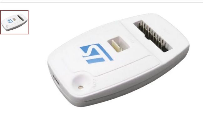

Hello, I would like to know with which debugging tool we can work with the Nucleo L433 card ? After the datasheet I can see : 'On-board ST-LINK debugger/programmer with USB re-enumeration capability: mass storage, Virtual COM port and debug port'
DYann.1
Senior II
But What It's mean exactely ? I must buy a Debugger like ST-LINK/V2 ? 0693W00000GWTMTQA5.jpgThank you for your helps.

No, no need to buy more stuff. Nucleo boards come with an on-board ST-LINK chip. For SW Development use STMCubeIDE.

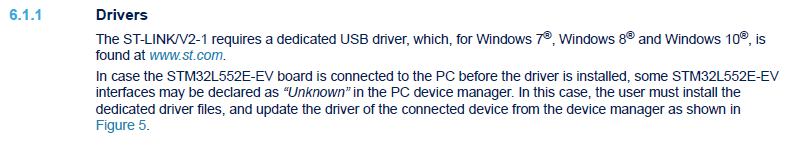

I come back again. Now I have a evaluation board STM32L552, after the DS I must install the driver. Fo you know how I can find this driver please ? I installed on my PC only the STM32CubeMX only for this moment.

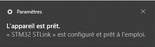

 0693W00000NpbNpQAJ.png After to connect directely USB, I think the driver detection is correct :
0693W00000NpbOdQAJ.pngBut now the next step is How to work with this Evaluation Board ?
The answer is exactly the same as for Nucleo and Discovery boards! The driver is the same for all implementations of ST-LINK:
https://www.st.com/en/development-tools/stsw-link009.html
