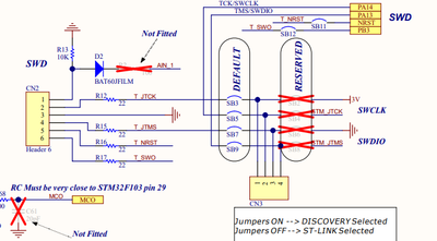

I am trying to connect to the processor STM32L431CCT6TR via SWD connection, but it says no device found.  Blowe, I have pasted the message and debugger setup information.  It is able to find the debugger. I have also attached the schematic if

I advise you to connect under reset mode.
Check boot pin, NRST and SWD signal.
Also, make sure to upgrade the firmware.

Hi Imen,
Thanks for the response. I have pull-down on boot.  I have NRST is pulled high.  I have upgraded the firmware on the programmer.
Moreover, I tried connecting the programmer to discovery board, but I was not able to read the memory with ST utility tool.
Here is the connection that I had used.   I had removed the jumper, so I can communicate.
