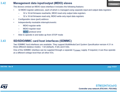

I would like to know if the Nucleo-H7A3ZI-Q supports the MDIO to external Ethernet PHY control via SMI (MDC and MDIO). I have the setup connected, and I have programmed it accordingly but the MDC and MDIO Lines are always LOW, not even a hint of toggling or any thing on the PINS when viewed on a logic analyser.
This brings me to my question. Does the Nucleo-H7A3ZI-Q support control on an external PHY.

Hello @Promise_Conti ,
MDIOS can't communicate with an external PHY because the PHY will behave as a slave also so no one will initiate the communication.
you need to have a master communicating with MDIOS providing its clock so normally you will not see any traffic on the MDIO /MDC lines as a clock and a command to the address programmed in the slave should be provided.
otherwise MDIO/MDC are quite simple to emulate using normal GPIO if you are constrained to use this product series, or you can switch to a product supporting master MDIO/MDC communication.
please refer to sections 59.3.3 and 59.3.5 of RM.

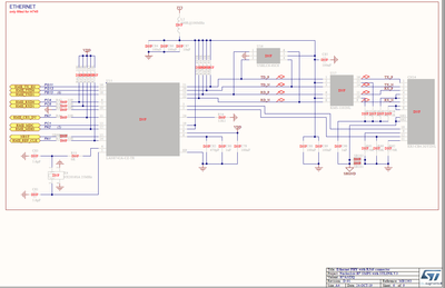

I don't see any ethernet components (RJ45, transformer, PHY) on this photo:
https://www.st.com/en/evaluation-tools/nucleo-h7a3zi-q.html
Edit: H7A / H7B do NOT have ethernet peripheral!

- check the Nucleo schematics and find the SMI pins

Hello @Promise_Conti and welcome to the community,
By defaults, Nucleo-H7A3ZI-Q does not have the PHY nor the transformer for the ethernet function.
See the schematics. All the components related to the ETH are not fitted:

As LCE wrote, the STM32H7A3 series don't have Ethernet . In particular, no ethernet MAC component.
There is a STM32 peripheral called "MDIOS" ("Management data input/output") that could be used for very basic serial interface, but the Ethernet MAC component is missing in this specific STM32H7 to do real Ethernet communication with an external PHY.
Ethernet MACs are present in other STM32H7s.

I do not need the onboard Ethernet PHY on the Evaluation board, I only need the SMI (MDC and MDIO) pins, I have an Ethernet PHY on an external board with I would like to communicate with.
According to DS the PA2 and PC1 should support this function, but this does not respond and are always LOW

The STM32H7A3 seems to have the MDIO interface, my problem is that it seems responsive even when called via HAL_MDIO
