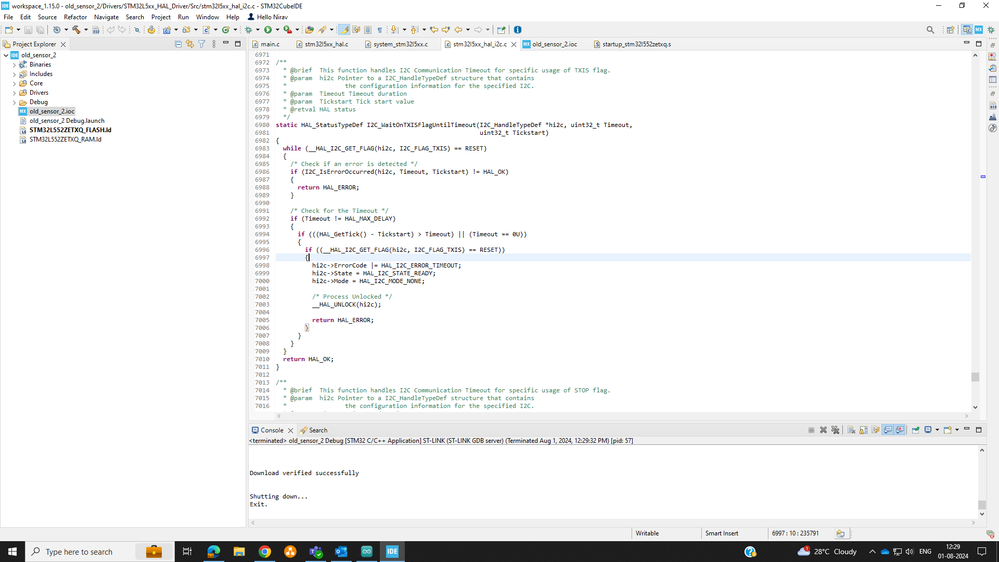

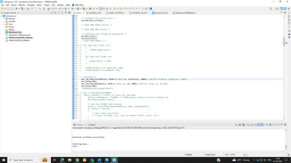

HAL_GetTick() returns the value -128 when called in I2C write memory bite
Here are the code snipets how to resolve this errorScreenshot (19).pngScreenshot (20).pngScreenshot (21).pngScreenshot (22).png
Why do you think this?
The return value is uint32_t. It cannot be negative.

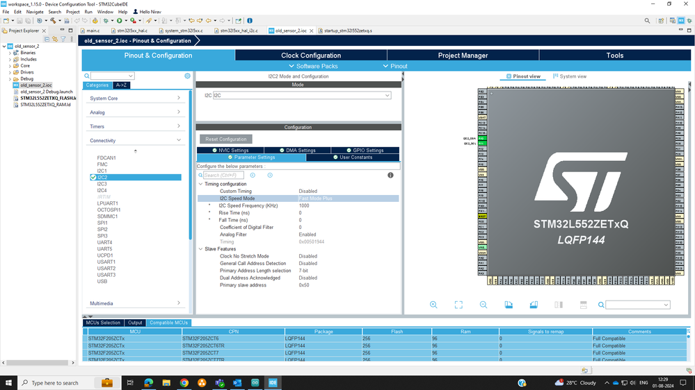

Use HAL_I2C_IsDeviceReady and ensure it returns HAL_OK before using any other I2C function.
If it's not returning HAL_OK, there is likely a hardware error. Perhaps SDA/SCL is miswired, or you have missing external pullup resistors, or other issue.
 it's not returning HAL_OK,.SDA/SCL is wired properly and external pullup resistors are also present. Do let me know what other issue can be there and how can i solve it
