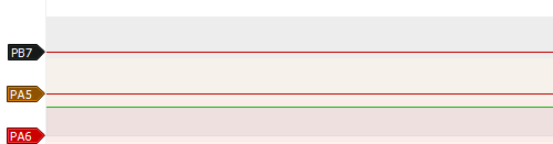

When I set the 3 GPIOs like so, I have expected results.
HAL_GPIO_WritePin(GPIOB, GPIO_PIN_7, GPIO_PIN_RESET);
HAL_GPIO_WritePin(GPIOA, GPIO_PIN_5, GPIO_PIN_RESET);
HAL_GPIO_WritePin(GPIOA, GPIO_PIN_6, GPIO_PIN_SET);
0693W00000Kb8SbQAJ.pngPB7,PA5 are low and PA6 is high.

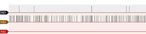

The next condition I test:
HAL_GPIO_WritePin(GPIOA, GPIO_PIN_5, GPIO_PIN_SET);
HAL_GPIO_WritePin(GPIOA, GPIO_PIN_6, GPIO_PIN_RESET);
Should show PB7 low, PA5 high ad PA low.
But instead I see this:
0693W00000Kb8UDQAZ.pngPA5 appears to be bouncing all over the place, and once in a awhile PB7 does as well.
(This is short sample, of like 5 seconds)

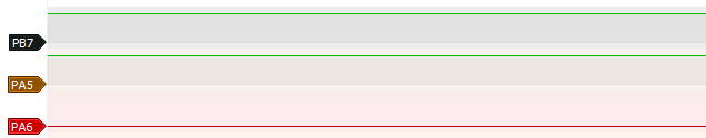

Finally, when I do this:
HAL_GPIO_WritePin(GPIOB, GPIO_PIN_7, GPIO_PIN_SET);
I see these results:
0693W00000Kb8V1QAJ.pngBoth PB7 and PA5 are high, and steady.

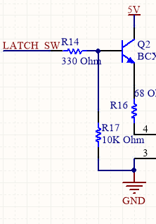

Each circuit is tied to a 10k pulldown resistor.

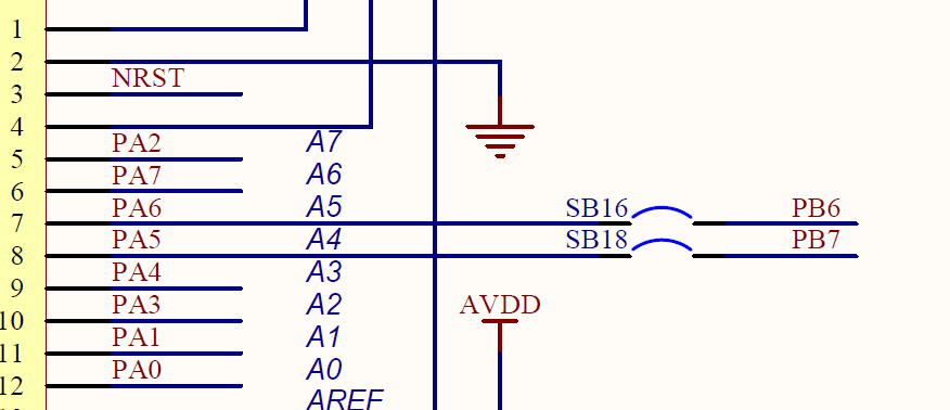

I don't quite understand a) why won't PA5 stay up, and how is PB7 somehow tied to PA5.
If anyone has some ides, I'd appreciate it.
jgauthier
Senior
Thanks! I finally figured it out,
PA and PB7 are directly connected through solder bridge on the Nucleo. I removed the bridge.

The npn bipolar transistors are current driven and emitter followers, so you'd need some load connected to them. What is connected at the outputs?
Regards
/Peter
I didn't have a load, actually. But I attached my intended load. Which are 2 24V solenoids (relays not pictured)
The behavior is the same regardless. So, I am still hunting - maybe it's hardware issue.
