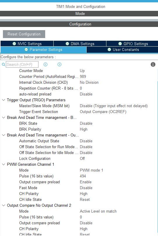

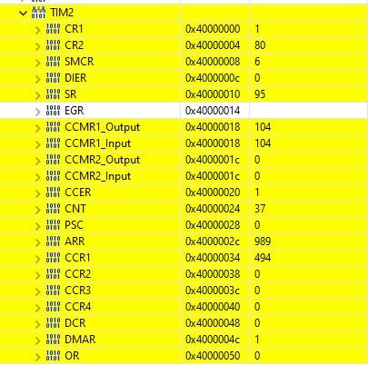

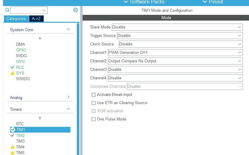

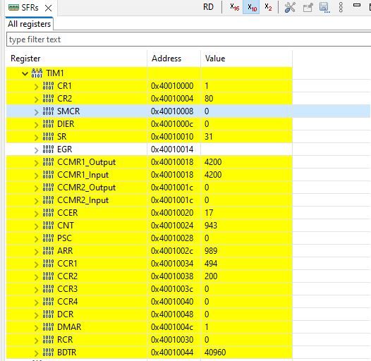

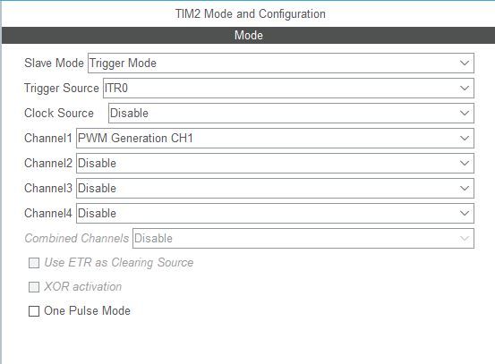

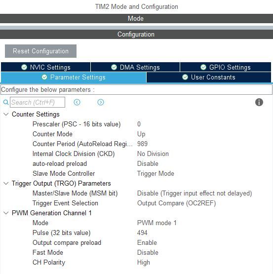

Hello everyone,
I'm new to using STM32 boards and coding with STM32CubeIDE. I have a simple task: generating two PWM outputs and adjusting the phase difference between these two PWM signals at runtime.
I'm using an STM32F407 board, and from what I've gathered through online research, I need to use two timers, one in master and another in slave configuration. For the master Timer (Timer 1), I've set up two PWM channels. Channel 1 of Timer 1 is for PWM generation, and Channel 2 of Timer 1 is for triggering Timer 2, which is set to 'output compare no output' mode. I followed a tutorial on YouTube (Timer Sync Tutorial ) to configure these channels.
The pulse value set in TIM1 CH2 is supposed to change the phase of the PWM generated by Timer 2. However, I'm unable to change the phase at runtime. I've tried changing the value of the CCR2 register in the main code, but it doesn't affect the phase despite updating CCR2.
Could someone please point out my mistake and provide the correct syntax? And if possible, could you explain it in simpler terms, as I'm relatively new to this?

  HAL_TIM_PWM_Start(&htim1, TIM_CHANNEL_1);
  HAL_TIM_OC_Start(&htim1, TIM_CHANNEL_2);

    htim1.Instance->CCR2 =400;

static void MX_TIM1_Init(void)
  /* USER CODE BEGIN TIM1_Init 0 */
  /* USER CODE END TIM1_Init 0 */
  TIM_MasterConfigTypeDef sMasterConfig = {0};
  TIM_OC_InitTypeDef sConfigOC = {0};
  TIM_BreakDeadTimeConfigTypeDef sBreakDeadTimeConfig = {0};
  /* USER CODE BEGIN TIM1_Init 1 */
  /* USER CODE END TIM1_Init 1 */
  htim1.Instance = TIM1;
  htim1.Init.Prescaler = 0;
  htim1.Init.CounterMode = TIM_COUNTERMODE_UP;
  htim1.Init.Period = 989;
  htim1.Init.ClockDivision = TIM_CLOCKDIVISION_DIV1;
  htim1.Init.RepetitionCounter = 0;
  htim1.Init.AutoReloadPreload = TIM_AUTORELOAD_PRELOAD_DISABLE;
  if (HAL_TIM_PWM_Init(&htim1) != HAL_OK)
    Error_Handler();
  if (HAL_TIM_OC_Init(&htim1) != HAL_OK)
    Error_Handler();
  sMasterConfig.MasterOutputTrigger = TIM_TRGO_OC2REF;
  sMasterConfig.MasterSlaveMode = TIM_MASTERSLAVEMODE_DISABLE;
  if (HAL_TIMEx_MasterConfigSynchronization(&htim1, &sMasterConfig) != HAL_OK)
    Error_Handler();
  sConfigOC.OCMode = TIM_OCMODE_PWM1;
  sConfigOC.Pulse = 494;
  sConfigOC.OCPolarity = TIM_OCPOLARITY_HIGH;
  sConfigOC.OCNPolarity = TIM_OCNPOLARITY_HIGH;
  sConfigOC.OCFastMode = TIM_OCFAST_DISABLE;
  sConfigOC.OCIdleState = TIM_OCIDLESTATE_RESET;
  sConfigOC.OCNIdleState = TIM_OCNIDLESTATE_RESET;
  if (HAL_TIM_PWM_ConfigChannel(&htim1, &sConfigOC, TIM_CHANNEL_1) != HAL_OK)
    Error_Handler();
  sConfigOC.OCMode = TIM_OCMODE_ACTIVE;
  sConfigOC.Pulse = 247;
  if (HAL_TIM_OC_ConfigChannel(&htim1, &sConfigOC, TIM_CHANNEL_2) != HAL_OK)
    Error_Handler();
  __HAL_TIM_ENABLE_OCxPRELOAD(&htim1, TIM_CHANNEL_2);
  sBreakDeadTimeConfig.OffStateRunMode = TIM_OSSR_DISABLE;
  sBreakDeadTimeConfig.OffStateIDLEMode = TIM_OSSI_DISABLE;
  sBreakDeadTimeConfig.LockLevel = TIM_LOCKLEVEL_OFF;
  sBreakDeadTimeConfig.DeadTime = 0;
  sBreakDeadTimeConfig.BreakState = TIM_BREAK_DISABLE;
  sBreakDeadTimeConfig.BreakPolarity = TIM_BREAKPOLARITY_HIGH;
  sBreakDeadTimeConfig.AutomaticOutput = TIM_AUTOMATICOUTPUT_DISABLE;
  if (HAL_TIMEx_ConfigBreakDeadTime(&htim1, &sBreakDeadTimeConfig) != HAL_OK)
    Error_Handler();

  TIM_SlaveConfigTypeDef sSlaveConfig = {0};
  /* USER CODE BEGIN TIM2_Init 1 */
  /* USER CODE END TIM2_Init 1 */
  htim2.Instance = TIM2;
  htim2.Init.Prescaler = 0;
  htim2.Init.CounterMode = TIM_COUNTERMODE_UP;
  htim2.Init.Period = 989;
  htim2.Init.ClockDivision = TIM_CLOCKDIVISION_DIV1;
  htim2.Init.AutoReloadPreload = TIM_AUTORELOAD_PRELOAD_DISABLE;
  if (HAL_TIM_Base_Init(&htim2) != HAL_OK)
    Error_Handler();
  if (HAL_TIM_PWM_Init(&htim2) != HAL_OK)
    Error_Handler();
  sSlaveConfig.SlaveMode = TIM_SLAVEMODE_TRIGGER;
  sSlaveConfig.InputTrigger = TIM_TS_ITR0;
  if (HAL_TIM_SlaveConfigSynchro(&htim2, &sSlaveConfig) != HAL_OK)
    Error_Handler();
  if (HAL_TIMEx_MasterConfigSynchronization(&htim2, &sMasterConfig) != HAL_OK)
    Error_Handler();
  if (HAL_TIM_PWM_ConfigChannel(&htim2, &sConfigOC, TIM_CHANNEL_1) != HAL_OK)
    Error_Handler();
  /* USER CODE BEGIN TIM2_Init 2 */
  /* USER CODE END TIM2_Init 2 */
  HAL_TIM_MspPostInit(&htim2);

Dear @waclawek.jan ,
Thank you for your detailed answer. I followed your methods, but none of them solved the problem. I also set up another timer, TIM3, as the master for TIM2 and set TIM3 CH1 as "output compare no output," following the settings from the reference manual of STM32F407. However, that did not help.
Attached are the screenshots of TIMx and CHx configurations along with register values. I still cannot figure out why I am facing this problem, even though I have tried almost everything I could find on the internet. So far, I have not found any demonstrations of varying phase shifts in runtime. What should I do?
TIM1 RegistersTIM1 RegistersTIM2 RegistersTIM2 RegistersTIM1 ConfigTIM1 ConfigTIM1 Config-continuedTIM1 Config-continuedTIM2 ConfigTIM2 ConfigTIM2 Config-continuedTIM2 Config-continued
waclawek.jan
TIM1->CR2 = 0x80 means TIM1_CR2.MMS = 0b000 which is different from what you want, which is probably TIM1_CR2.MMS=0b101 (Compare - OC2REF signal is used as trigger output (TRGO)).
I don't use CubeMX nor Cube/HAL and I am not interested in finding reasons why it does not work as intended. IMO timers are simple enough to be programmed normally through direct register access.
