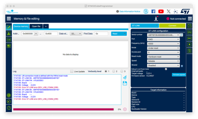

My company recently purchased a new ST-Link/v2 programmer. The problem is that after the firmware update, the device stopped working, and when I press the Connect button on the STM32CubeProgrammer, the following error appears:
Error: ST-LINK error (DEV_USB_COMM_ERR)

Hello @SSerg.4 ,
Did you try click 'Open in Update Mode' ?
Are you using latest release of STM32CubeProgrammer?
Check and configure the correct access port. ST-LINK fail to access to the device as the port number may become inaccessible due to incorrect access port configurations.

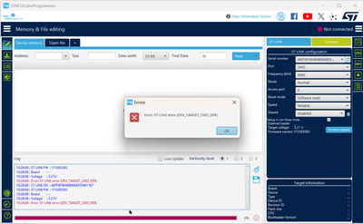

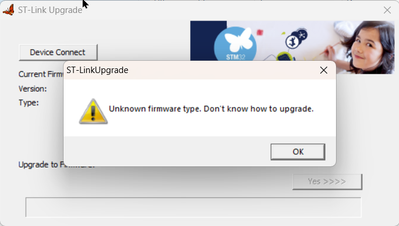

I followed your advice using a Windows PC and these are the results:
Nothing changed. Do you have any other suggestions? The device is brand new. All I did was update the firmware.
Thank you.
Stefano

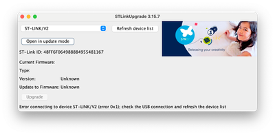

Hi Imen, thanks for the reply.

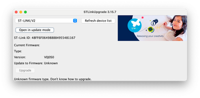

I already clicked the "Open in upgrade mode" button.
The first time I click it, the following message appears:
"Error connecting to device ST-LINK/V2 (error 0x1); check the USB connection and refresh the device list"
The second time I click it, the following message appears:
"Unknown firmware type. Don't know how to upgrade."
Look at the images I attached.
I also used a Windows PC and installed the latest version of STM32CubeProgrammer, but the results were the same (see my reply to Pavel).
Thanks.
Stefano

Pavel A.
The root of the problem seems to be that the updater does not recognize the present firmware version V15J63S63
Which looks totally weird. The number after V can be 2,3,4. Not 15.
Has someone else played with it? Updated it with J-Link or other 3rd party firmware?

Hello Stefano,
Unfortunately this is not a recoverable error, you should return the ST-Link and exchange it with the distributor.

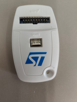

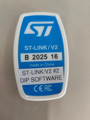

To check if it is a genuine ST-LINK/V2 could you provide a picture of the box and its stickers and of the provided accessories?
