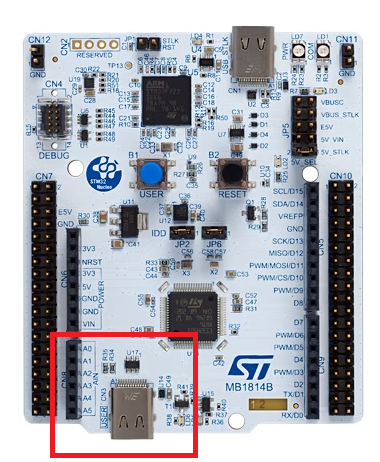

mƎALLEm
As said by @Andrew Neil , Nucleo-G431RB board doesn't have a USB OTG connector.
Meanwhile for example NUCLEO-H503RB has that USB connector.
STM32H503 has a FDCAN interface but you need to add a CAN/FDCAN transceiver as the board doesn't have one.
An example of USB CDC ACM is available in STM32H5 Cube HAL package using USBX stack under the link Projects\NUCLEO-H503RB\Applications\USBX\Ux_Device_CDC_ACM
