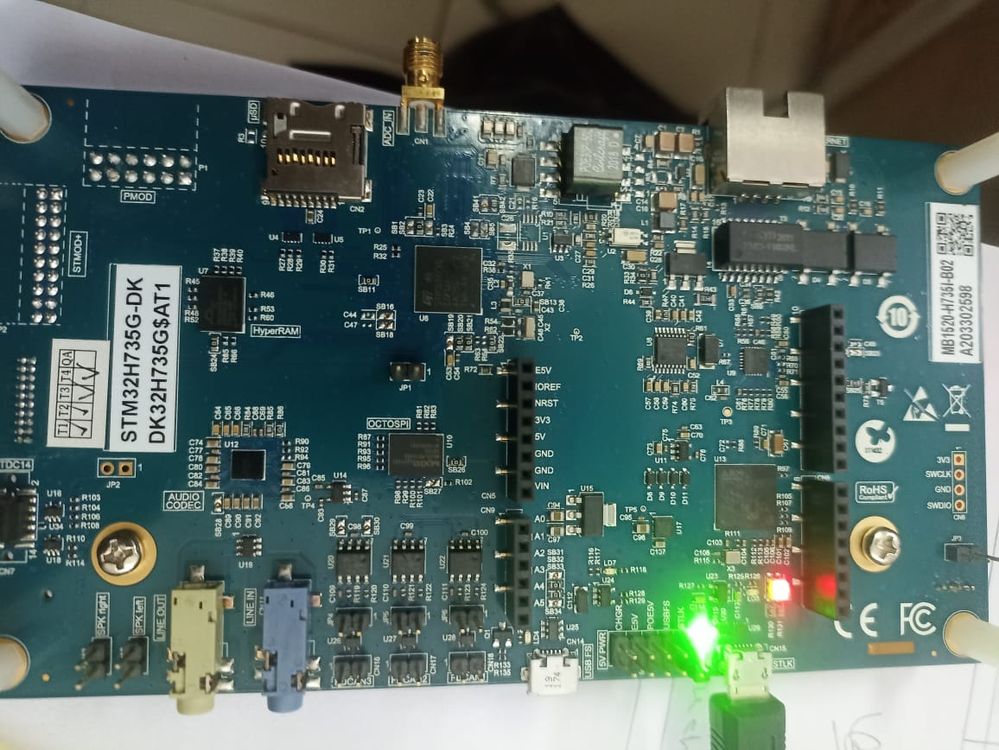

  1. current jumber is connected. and i have checked current consuption by removing JP1 and keep multimeter across it is 60 miliamp. i have connected board using ST link.0693W00000WLJGNQA5.jpg0693W00000WLJGDQA5.jpg

Check the vdd sensed line going.to stlink.
Check the boot pin
Check if the oscillator is working
Use STLink and try to go debug mode

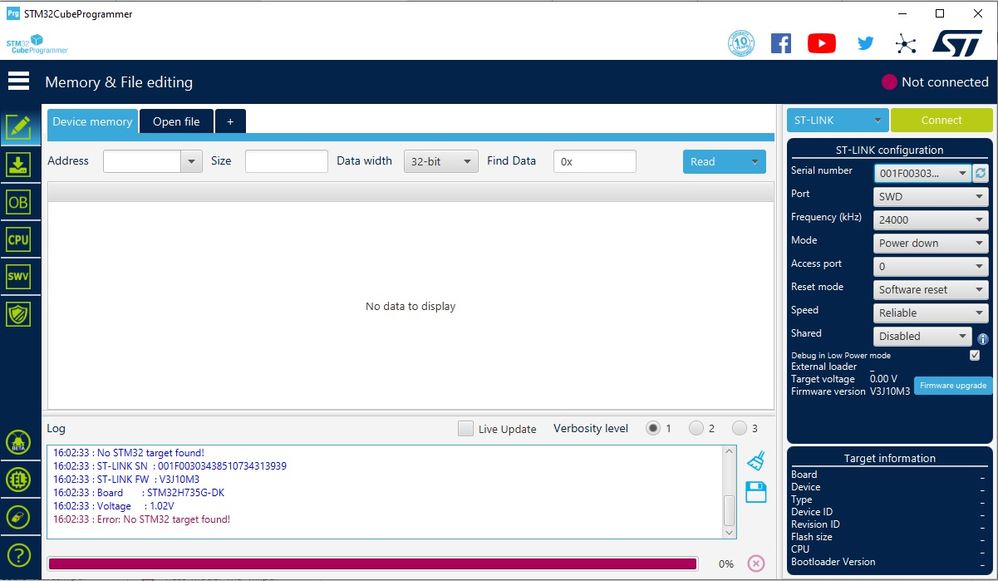

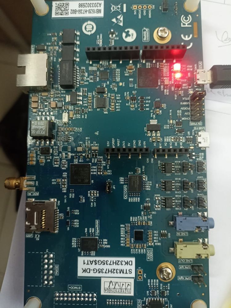

Hi..
I followed to connect board under power down mode but still getting same issue No STM32 target found!.
And one more LED LD3 continue ON..
This LED is for STLINK-V3E Over Current.
