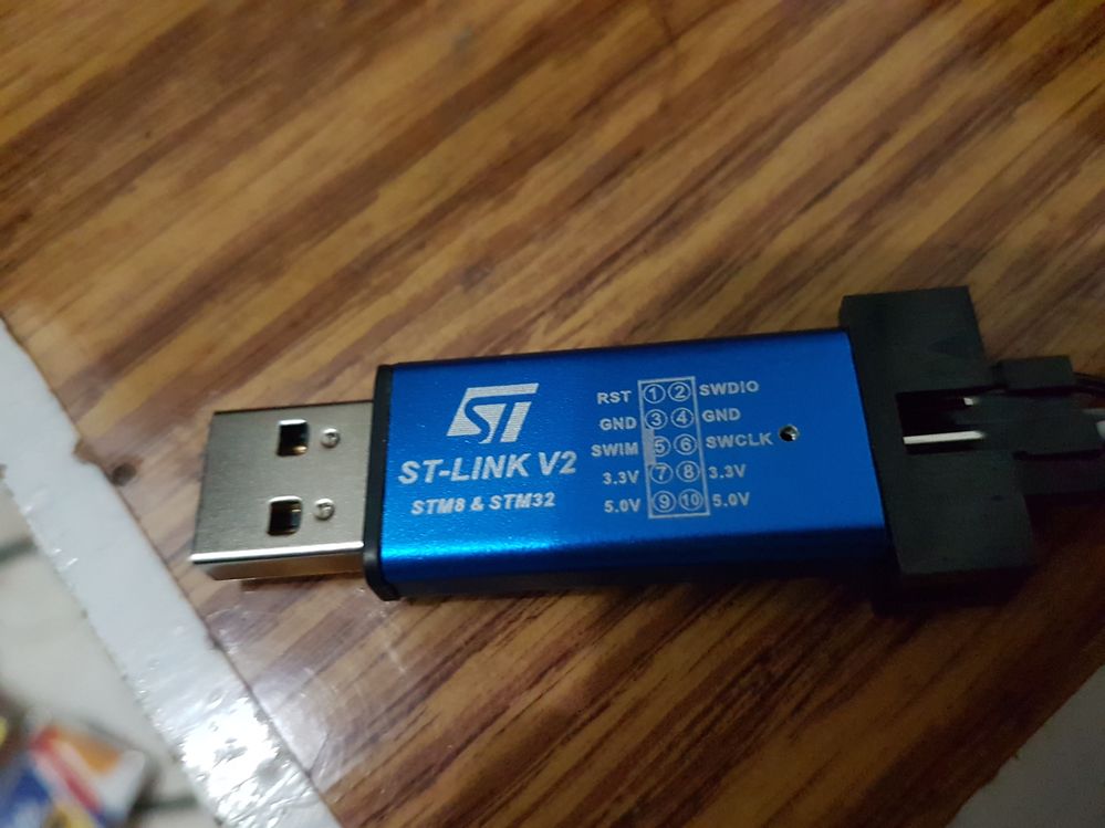

I have already follow your suggests. But, it still in same condition. so, I bought a new one, The ST-Link Dongle 10pin.
Figure 1. The ST-Link Dongle 10 pin
Even my new dongle is still not working :(

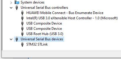

The dongle is already detected in my device manager
Figure 2. The Device Manager Conditions

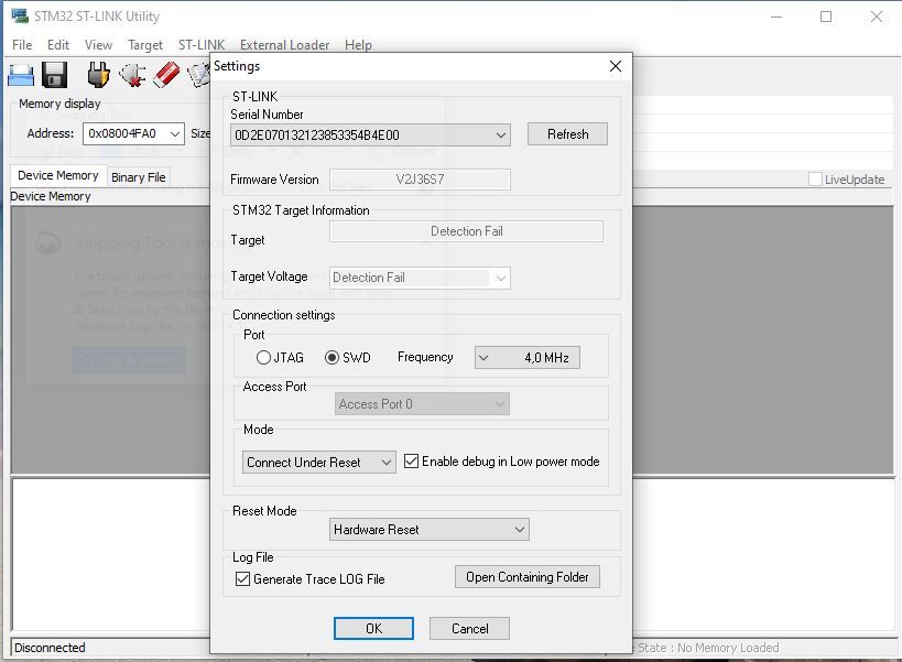

Figure 3. The ST-Link Utility v4.1.0 Interfaces
I really really dont get it what the problem is.

After trying several cases. Then, The Figure 1 (The ST-Link Dongle 10 pin) is not broken. I try to connect the dongle into another STM32 and The ST-Link Dongle works fine. So, I think the STM32F103C8T6 board is broken.
I lost my ST-Link 20 pin, but no problem. The dongle could be use.
