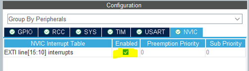

Hello, i am trying to run a simple code that toggles the built-in led when i press the built-in user button. I wanted to do this manually using HAL library functions, but for some reason i do not seem to get it right somewhere. The code generated using CubeMX software works, but when i try to code it on my own, i cannot turn the led on. This is the code, and it already is very similar to the code that mx generated. Is there a library or a function that i'm missing?

Karl Yamashita
Principal
Why do you have EXTI15_10_IRQHandler inside the while loop?
while(1){
	void EXTI15_10_IRQHandler(void) {
	HAL_GPIO_EXTI_IRQHandler(GPIO_PIN_12);
	HAL_GPIO_EXTI_IRQHandler(GPIO_PIN_13);
That is already in stm32xxxx_it.c file.
Did you enable the NVIC for that GPIO?

Pavel A.
Nothing is too simple for a beginner. So let's look at your code again.
* The code probably does not compile as is because there are nested functions? You cannot run the program unless it compiles without errors.
* Why two interrupts on pins 12 and 13? You wrote about one "built-in user button". Is it a Nucleo board? What is another interrupt for?
