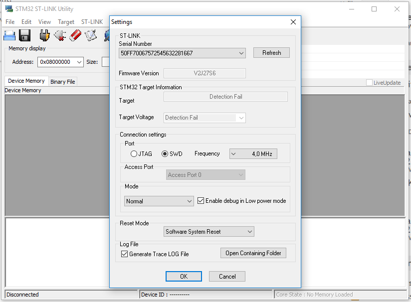

This is the dialog window when using the STLink Utility:

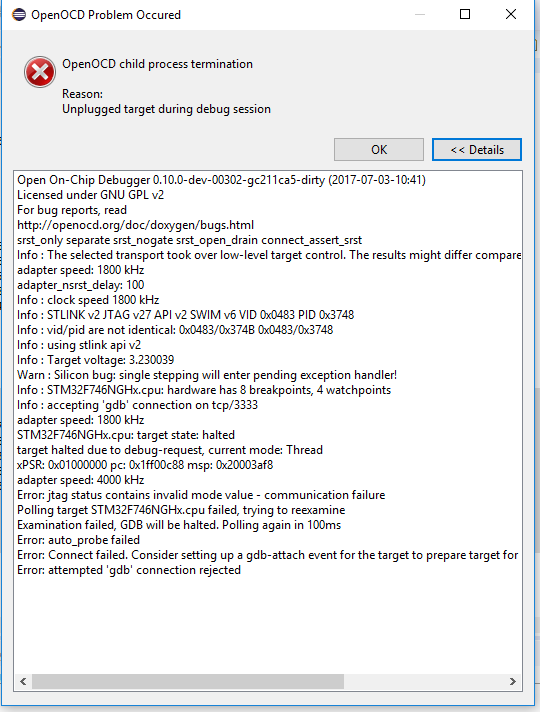

As you can see, we can't even detect the target MCU (STM32F746). Also, when we try to program it using SW4STM32, this is the output:

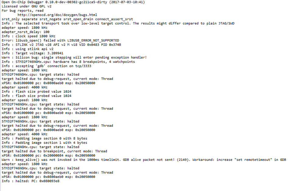

It seems like it's trying to use the JTAG connection to program, but we're using the exact same options as when we program the STM32F746G-Disco board. And that is always successful:
Any idea of what's going on?

Holding the reset low gives the following message:
Info : accepting 'gdb' connection on tcp/3333
Error: auto_probe failed
Error: Connect failed. Consider setting up a gdb-attach event for the target to prepare target for GDB connect, or use 'gdb_memory_map disable'.
Error: attempted 'gdb' connection rejected
