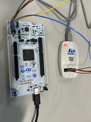

Embedded ST-Link via CN1 USB is working fine. I followed the direction as below when external ST-Link v2 was tried on STM32L552ZET6Q Nucleo-144. The error message "No Target" was displayed on STM32CubeIDE with external ST-Link. Could you provide me with any advice?
CN5 is no longer connected to SWD on the target chip since you've disconnected CN4. It's connected to the st-link chip.

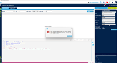

  • Try connecting with STM32CubeProgrammer. Does it report a target voltage? Does it connect? Show screenshots if you get errors.

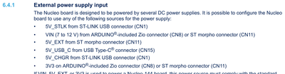

2. USB C at CN15 is used as board power supply. pin 7 and 8 is on JP6 for external power.

4. Please check the screen capture as below. Target board voltage is pretty low as 0.23 (Probably shall be around 3.3v).
USB C is not enough external power?
0.23 V is not enough voltage for the device to run.
How is the device powered? The programmer does not provide power. The VCC pin is an input to the programmer.
There are a number of ways to power the board. You need to have one of those present. See the user manual for details. CN15 should work.

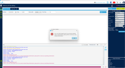

pin #1 on CN5 is connected to pin #1 on 20 pin connector of ST Link v2. L552E-Q board is powered from USB C (CN13). Board connection with ST link v2 is captured as below.
After CN5 pin1 is connected to 3.3V on CN8, target voltage is 3.24v. However, still NO STM32 target found.

After two jumpers are back to CN4, external ST-link v2 starts working. Thanks for your support.
