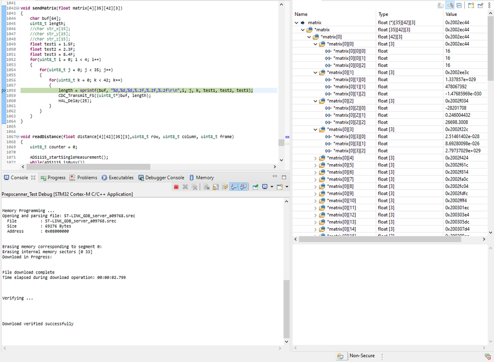

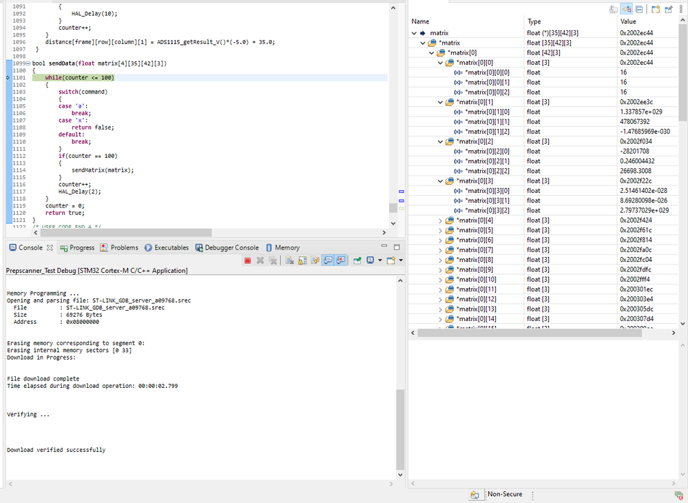

I'm trying to transmit a 4D array of floats from an stm32l552zet6q to a PC using a USB connection. I can collect the array elements and store them, but when I pass the array into the transmission function, I don't see the same elements.
This image is of the array values as they should be, and are when outside the sendData and sendMatrix functions.
0693W00000UnqDjQAJ.pngAnd this image is what arrives inside the sendData/sendMatrix functions:

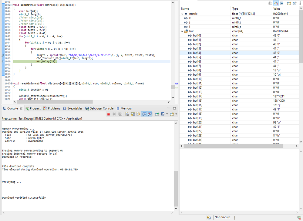

0693W00000UnqE8QAJ.png0693W00000UnqEIQAZ.pngAdditionally, I cannot get sprintf to format a string with ANY float values, as shown in the below screenshot

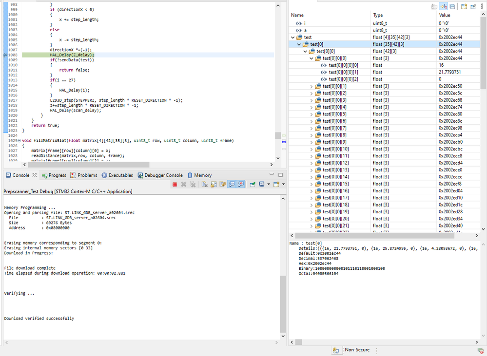

0693W00000UnqErQAJ.pngThe test matrix I've declared is a local variable with a defined size (test[4][35][42][3]).
I've tried altering the code to instead use pointers to the test matrix, but I get the exact same results, though it's entirely possible I was using them incorrectly. Any assistance is appreciated.

Unfortunately, that doesn't solve the problem of the floats not showing up when I use sprintf to format a string that includes them. I even replaced the array with three separate floats to see if that changed things and it didn't. I've read that there's a known bug with ST linkers that can prevent floats from working, but I can't find it in my linker.
Found the final problem. At some point, I'd accidentally changed configuration from debug to release, and did so before enabling the sprintf float option. So, whenever I fired up debug, I couldn't send any float information. I switched back to debug, re-enabled the float sprintf option, and everything is working
