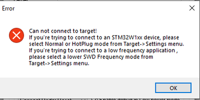

2. With external ST Link V2 USB dongle.
                  The device manager shows this for 2nd approach;
                   But, stLink utility sw responds with this; cannot connect to target.

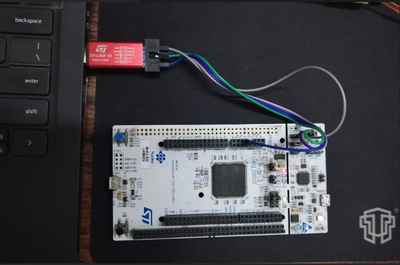

Is it possible to interface nucleo board with external st link, when it has inbuilt st link?

For your Q can connect external stlink = yes ofcourse, you maybe see on nucleo precut part top side on your image. You can cut this onboard stlink completely... Too if your stlink on nucleo isnt detected maybe you reconnect jumpers to fail config or kill stlink ... or full board.

Attaching image:
If this setup works at least, its enough for me to get started.
Can u check where it could go wrong?
Thanks
Pavel A.
Try another computer. And another USB cable.
Aghhh your knowledge is under level for this designs.
1. Connector you use is designed for output from Nucleo programmer when is cutout NO as input, you create backpower loops ...
2. Your board need own powering before use external Stlink
3. From external Stlink start only with 3 wires GND SWDIO SWDCLK based on code inside MCU maybe fourth wire NRST is required, but your external clone dont have it. (RST on it is STM8 based)
