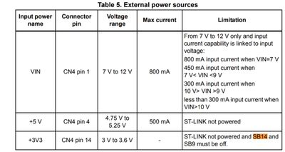

I need to test power consumption on NUCLEO-L432KC with UART working on high baud rate. I've removed SB9 and SB14 to do so. Board is powered by external 5V source. While trying to flash following the Chapter 6.4.2 (External power supply inputs) from User Manual I get:

According to the UM1956, ST-LINK is not powered when using 5V or 3.3V power supply.
 best regards.

My colleague managed to flash the board a couple of times(it was very unstable), but we couldn't figure out a difference in our configuration. Also the next paragraph says:

If you are using+5v mode then why you have removed SB9 and SB14. You have to do this in case you are using 3v3.
