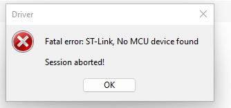

hi all,
I am using STLINK/V2 ISOL which says ST_LINK, No MCU device found, just replacing with STLINK/V2 works keep all setup intact.
what could be the reason.

Hello @prudhvichitturi
Are you sure your STLINK/V2 ISOL is the official ST product ( is an original STLINK). It may be a replica.
Best regards.

prudhvichitturi
i bought it from RS , I think it is an official product. I am using stm32L051rz.
It flashes fine with ST-LINK/V2 , but not with ISOL.
AScha.3
your target is powered ? because st-link isol has no power output , st-linkV2 has power out.
so check voltage on your L05 board, when using  st-link isol .
prudhvichitturi
Ok , that might be the difference, i thought both are the same apart ISOL. i will check it again. could you please point out the power out difference in the datasheet.
UM1075, Table 4, Vdd + GND :
