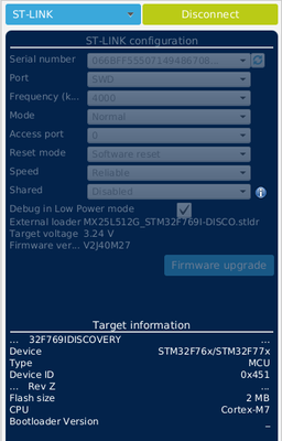

The board is MB1225-F769I-B03 with the MB1166 Rev A display board.
It appears when connecting it to STM32CubeProgrammer and I can read the memory out of it seemingly.
0x00000000 is 0x58306F8E (I can read up to 0x3FFF fine)
0x00100000 starts 0x20003420 (see attached) which is BOOT_ADD1
0x00200000 is just 0xFFFFFFFF which is BOOT_ADD0
0x80000000 is 0x00000000
0x90000000 is also 0x00000000
Is there a hex file for the default application which I can flash onto the device just to check it works before adding in the unknowns of getting my build environment setup?

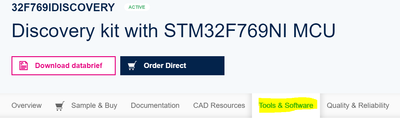

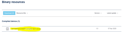

Here is how to download them :
  - Please refer to the : https://www.st.com/en/evaluation-tools/32f769idiscovery.html#
  - Go to "Tools & Software"
 - At the end of the page you will find "Binary resources" and the "compiled demos"

 This is the info about the target board in STM32CubeProgrammer which all looks okay to me. Annoyingly the UI hides some of the text behind "..."s. It shows that the external loader is there and it's found the parts okay.
The readme did say that for the media demos that I need to connect a USB stick with the provided media files on it, but I've had another dev kit board which still boots into the usual list of apps without needing this plugged in.
Are there any steps I'm missing in getting this board to work? Even doing a full chip erase first doesn't seem to have changed anything either.
