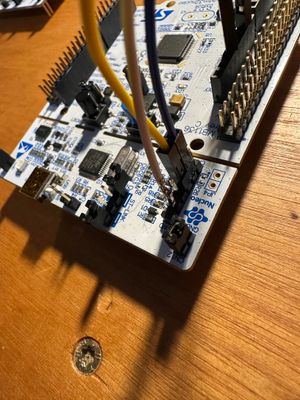

Set jumpers back and test link. If work Then show what you disconnect ...

The link is working as normal with jumpers on, also it is working fine with jumpers off on another custom board (L010 chip). I have attached the picture with the jumpers off. I think I need to get a new board done with the VDDIO2 and VSS connected properly as the flying wire maybe are not connected properly. The board was factory assembled so I assume that is right.

‎2024-11-17 1:00 PM
For normal use you require three pins connected GND SWCLK SWDIO and on your image GND isnt connected
plus custom board power ...
