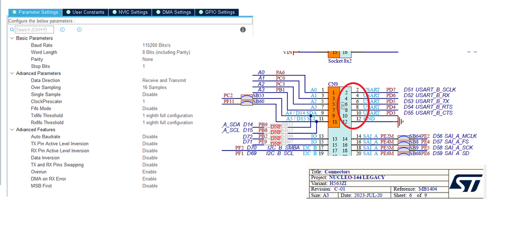

I've created a project for my Nucleo MB1404 - STM32HM563ZI board which uses USART2 and USART3 to send and receive data to a computer. I've just configured both UARTS in the same way with the same parameters with STM32CubeMX. The USART3 works without problems ( can send and receive data),that is the UART connected to the onboard debugging microporcessor which implements a USB virtual COM and  the debugging functionallities.
The problem is with USART2. I connected a "FTDI like" device that connects and converts the USART2 lines to a virual COM through USB in the computer. I can send bytes from the nucleo board to the computer and read them in the terminal software, but when I send data from the terminal software to the board I get HAL_TIMEOUT and can't read it. If I check the state of the USART with  HAL_UART_GetState(&huart2); I get HAL_UART_STATE_READY. I keep calling HAR_UART_Receive(... ) in a while for 20 seconds but it reads nothing, I only getTIMEOUT.

I've checked and confirmed with an oscilloscope/logic analyzer that the data is arriving to the board, but when I try to read the sent data it returns HAL_TIMEOUT. I've also checked on the NUCLEO board schematics and haven't found any other device connected to the USART2 pins that may be blocking communciations.

I found the origin of the problem: the Nucleo MB1404 - STM32HM563ZI evalutaion board schematics shows USART TX on PD5 and USART RX on PD6. On first instance I configured the USART2 with STM32CubeMx to work with these 2 pins, but at some point, I don' know when and how, the RX pin moved from PD6 to PA3, so despite I was sending data to PD6, the USART was receiving nothing. I moved the TX wire from PD6 to PA3 and started receiveing data. I think that the pin changed when I moved or enabled other peripheral that also used PD6.
Conclusion: check your STM32CubeMX configuration twice

The terminal software could be buffering bytes. Generally it will flush them when you send a newline.
Since you know transmitting works, you could set it up in loopback mode, though you will need to use non-blocking functions.
