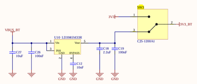

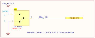

The schematic is provided. In the schematic, SW1 and SW3 are connected as described. R25 isn't relevant to SW1. AI hallucinating? Are these actual discrepancies or just made up stuff?
islavv
This is mainly documentation issues. I am early retired network and software engineer and not hardware engineer. Switches in B-U585 board is not described well and very contradictive. Boot0 was not very clear to me. If someone would write move in right position to boot normally or move left to load firmware it would be crystal clear. The fact that they are switches and not jumpers make life miserable. Silkscreen on SW1 is disaster. For SW2 i spent couple hours to find combination that allows to load firmware and then boot. NC Boot and NC ESLK.  And AI explained that those positions description in docs are not actual and do not do whatever described.  Major issue is CN12 not doing its job at all and USB-C CN1 that should be doing USB power only is in fact DFU and  conflicts via enumeration with CN8 that looses virtual com port on USART1 and stops printing. Also firmware for BLE that is in zip for update contains html file and will not work for sure. So I can not accept as Solution your diagrams at all though Thanks for attempt to help me. All documentation is useless for normal software developer.   With current state I was able to run HTTP Website demo but BLE is still silent.
Okay, I think that answers my question. You're going to have a rough time if you blindly believe what AI is saying.

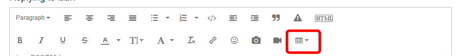

For that to work as a table, you'd need to use 'preformatted' text:
| Switch | Silk Legend        | Doc Says                           | Actual Result                                             |
| SW1 | BOOT0 ↔ NC_BOOT | BOOT0=1 → system loader boot | No pull-up resistor fitted → BOOT0 always = 0 |
| SW2 | NC_ESLK ↔ ESLK | NC_ESLK to isolate ST-LINK for DFU | Correctly breaks SWD, but legend “0/1” obscures net names |
| SW3 | ? (Wi-Fi console?) | Toggle to route MX3080 debug UART | No UART traces connected to any header |
See:
https://community.st.com/t5/community-guidelines/how-to-write-your-question-to-maximize-your-chances-to-find-a/tac-p/725146/highlight/true#M54
Note that there is also a Table option:
