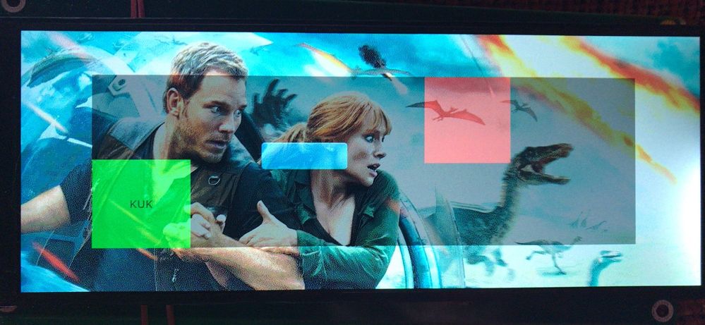

Here one example 1280x480

And simple reply to your question is all DSI displays with 2 LANE support (respect stm speed limit) you can connect to STM. But connect to any DK or eval board will require adapter boards ... for example primary because every lcd have own pinout and secondary voltage for backlight may require stepup convert...
