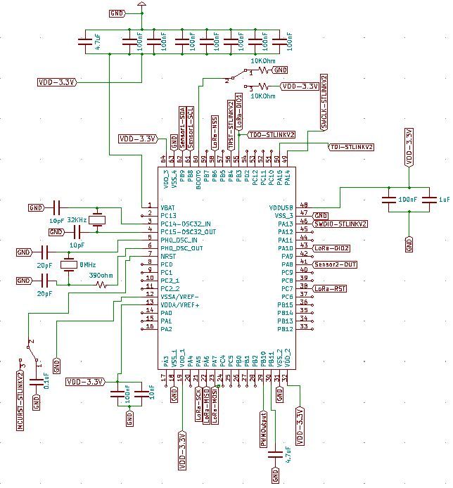

Can anyone here sincerely verify my schematic and let me know whether it'll work or not?
Prajnyajit
I'm mounting STM32L476RGT6U on PCB. For that, I have made this schematic. I need some expert suggestions from anyone who has in-depth knowledge of this. I'll use an ST-LINK V2 to debug and upload the program to the MCU on PCB.

We used these ST boards before making our own board
  • STM32L476G-EVAL (expensive)
  • STM32L496G-DISCO
  • You can load STM32L476 code onto either of these
Attached example schematic (pdf and DipTrace files)
  • L476_baseV00PR_DipTrace.zip
  • Proprietary circuits removed
  • STLinkV2 with UART (14pin)
  • Option: USB-C VCP
  • Option: DAC for real time diagnostics and
  • Option: Replace DCDC circuit with lower cost option if lower source voltage VH.
  • Option: LEDs and switches powered from 3V3, change resistors appropriately, careful of required voltage for selected LEDs, as indicators 0.1mA is often plenty.
  • RGB LED - Careful: Orientation mark is Pin4 Anode, not pin1. Ensure properly instruct solderer or factory, or delete it.
