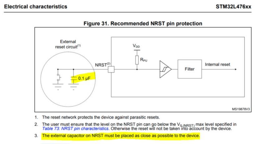

I'm mounting STM32L476RGT6U on PCB. For that, I have made this schematic. I need some expert suggestions from anyone who has in-depth knowledge of this. I'll use an ST-LINK V2 to debug and upload the program to the MCU on PCB.

You have changed NRST circuitry. This is usually a "wired or", see ref. I wouldn't use a serial capacitor in the way you did. NRST is an IO pin.
Didn't look into more details.

 0693W00000FB0uCQAT.jpgIt is referred exactly.
When the switch is in its left position, the C is open. When switched right while powered, a potential equalization will suddenly happed. In the above schem. the situation is more static, no switch.
My idea is like the switch will be towards the right (connected to the ground through the capacitor) most of the time, specifically when the device is running and performing normal activities. It will be only towards the left (connected to the MCURST pin of STLINK) when ST-LINK V2 will be connected with MCU for debugging and program uploading. The switching can be done through jumper manually.

  1. Don't like reset circuit. The cap should always be connected. Switch parallel to cap, Personally I add room for an external pullup 10K (you don't have to populate it, but I do). I don't see a good reason to do your Reset different from development PCBs.

  8. Switches: You have switches on BOOT0 and NRST that can leave those pins open when in middle state - DON'T. Put a pullup/pulldown and have the switch pull the signal the other way. i.e. a Pullup with a switch to GND. You don't want your signal floating, even if the switch is only two position and spends little time between. Floating == RF Antenna == Unpredictable behaviour should the switch change slowly or become faulty or be unpopulated. A cheap pullup resistor will avoid all those cases.
