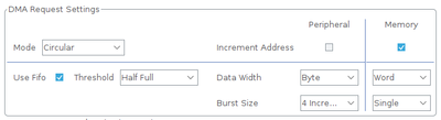

Hi, I have a problem. I want to store 262144 (256KB) bytes of data in a buffer from the integrated ADC on STM32H723ZG. However it fails when the buffer is too large. I started at an buffer size of 4096 elements (uint8_t) and doubled until 65536 where it failed (only output is 0, 0, 0...). I am using a circular buffer with continuous conversion on the DMA.
Can anybody help me to find out what the cause of this problem is, and how to fix it? The total capacity on the RAM_D1 is 320KB, so 256KB should be enough...

the limit is fix, "number of data" is a 16 b register.
you just want 8 bit from adc ? so set source to byte,
but if you using the cache and set destination to word (32 b), you could get 64k x4 = 256k byte.
(if it count the destination /32b tranfers - i dont know , just try it ! )
if not - try the MDMA .

Works at 65535, but everything above makes the DMA transfer fail (>=65536). Seems like the limit is at 16-bit :) Will have to find a workaround!
Maybe waiting for the:
HAL_ADC_ConvHalfCpltCallback(ADC_HandleTypeDef* hadc)
and
HAL_ADC_ConvCpltCallback(ADC_HandleTypeDef* hadc)
To do memory transfers of half the buffer at the time to another buffer.
