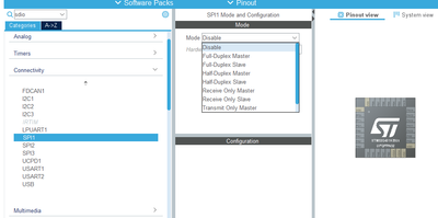

Just reading files from SD Cards can be done (and has been widely done) on simple 8-bit microcontrollers - so (pretty much) any STM32 will be able to do it.
At minimum, all you need is an SPI port.

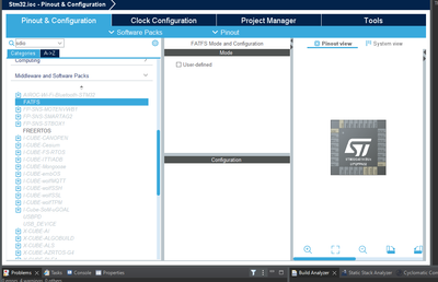

FATFS is already present as "middleware and Softwrae Packs" of the microcontroller I chose "STM32G431KBU6" CAN IT WORK OR DO I HAVE TO USE THE EXTERNAL LIBRARIES YOU SAID?. Do you know how I have to configure the SPI1: Full-Duplex Master is ok?
can you tell me exactly if I should use SPI or SDIO? I chose the µ STM32G431KBU6 which reads the .mp3 file and translates it into a DAC value with low precision
You can use either.
ISTR it's been reported that the version in Cube is rather out-of-date ?
