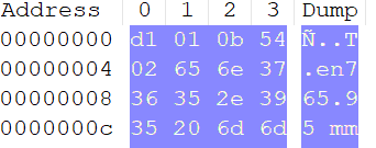

This is the memory bin file from the ST25 Tap app.
Thank you
the NDEF message seems to be written starting from block 0:
This is not compilant with NFC Forum T5T technical specification. Block 0 should contain the so-called Capability Container (aka CC). See Application Note AN4911 (ST25DV-I2C, ST25TV16K and ST25TV64K configuration to support a NDEF message).

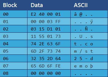

block #0 does not have a valid Capability Container and the NDEF TLV seems to start in the middle of the second block:
Your memory should look like:
In this dump, block #0 and block #1contains a valid CC starting with E2 (i.e. support of 2-byte address mode) and the NDEF TLV starts just after the CC (i.e. at the beginning of block #2).
Make sure to follow Application Note AN4911.

In the example, block #0 and #1 contain an 8-bytes Capability Container (CC). The various bytes of the CC are described in §3.1 of AN4911. The format of the 8-bytes CC is shown in table 4 of AN4911
Then, the NDEF TLV starts on Block #2:
  • 03h is the T-field for the NDEF
  • 15h is the L-field of this NDEF (i.e. the overall length)
  • the next byte D1h is the beginning of the record header. I would suggest the reading of 4. Introducing NDEF - Beginning NFC [Book] that provides a comprehensive description of the NDEF structure.
