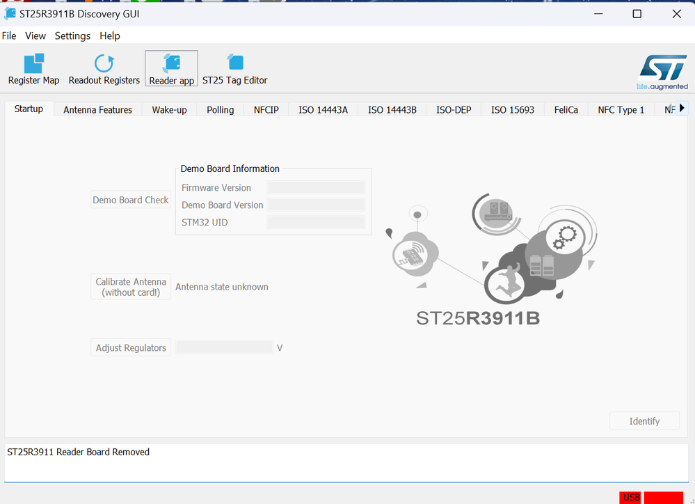

I connected these 2 kits in some PC but cannot connect to USB HID as shown in pictures
However when I unplugged the cable, the text "ST25R3911 Reader Board Removed" shown as in picture below.
The USB status always in red, no board detection.

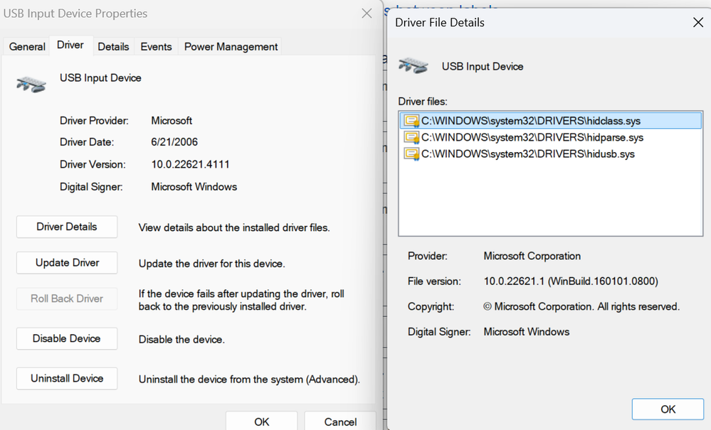

The windows 11 driver is shown in below picture

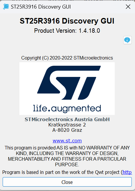

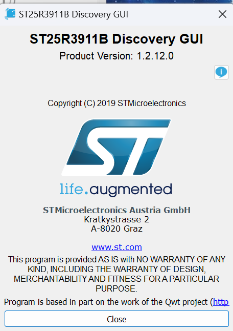

PC GUI for both kits were installed in latest version as shown below.

sorry, I think I cannot give you a good advice, the only thing I was able to do is doing research on the internet. Following it I would:
  • Compare the driver details and versions on the working and not-working PC
  • Try removing the device inside device manager and re-plugging the board.
Sorry, no further ideas and unfortunately I cannot reproduce.

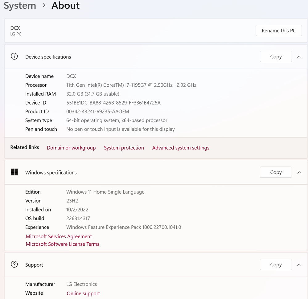

It's LG GRAM 17. Windows 11 Home since purchased.
And always updated to latest OS (now 23H2 OS build 22631.4317)
Another PC that's ok, no problem has the same 23H2 OS build 22631.4317 but Windows 11 Pro instead.
I did everything except bios update or reset PC to factory setting. I tried different ports, many hubs, uninstall, re-install. Nothing work. Now I gave up and moved to develop from PC desktop that has no USB HID problem.
