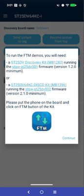

I use Android ST25 (ST25AndroidApp-V3.12.2) to communicate with NFC7(STM32L476RG) by FTM.

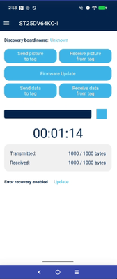

Click FTM demos of  Menu ST25DV Demostrations on Android ST25 APP, and click Send data to tag, 1000 bytes by default, the Transmission/Reception success with showd 1000/1000 bytes as showed in image below:

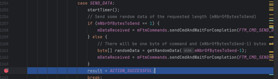

but the show exception "Command failed"  from
mDataReceived = mFtmCommands.sendCmdAndWaitForCompletion(...)
of source_ST25AndroidApp-V3.12.2\app\src\main\java\com\st\st25nfc\type5\st25dv\ST25DVFtmDemoActivity.java

I found error "22049: TxState = ST25FTM_TX_ERROR" in side.
How to fixed the issue?

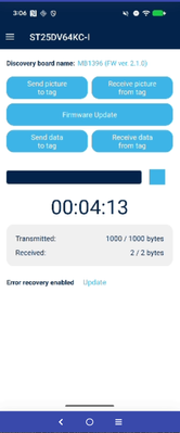

Hello
The X-NUCLEO-NFC07A1 is not developped to be in front of the Android demo
Only FW on Discovery board handle Android demo.
This is why Android demo + NFC07 raised the error : The NFC07 just do an echo of data received.
When exchange works, with FW of correct Mother board, here the result: 1000 bytes sent, 2 received
With NFC07 1000 bytes sent and 1000 received....
You have to adapt the FW demo for the demo with the NFC07 with the one provided for the discovery
