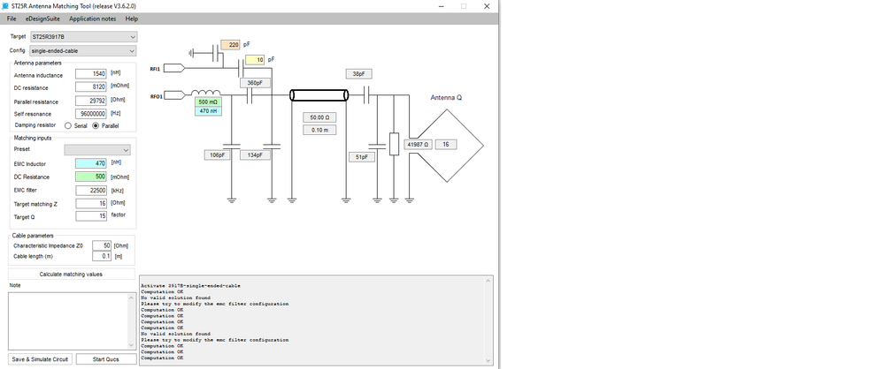

Sorry for late reply , thank you for the help for filling up the match tool. But i am still have several questions for it .
1. Since the antenna is already tuned to 50ohm ,  so you said[you don't need to fill the antenna parameters], but if i empty the antenna parameters of the tool, the tool would pops up a warning that stop the calculation, do i still need to feed some default parameter to it?.
2, Since the antenna was wired  , so i should select the single-ended-cable configuration. From the suggest parameter of the matching inputs, seems the present drop down menu is set to 16 ohms,what is the purpose of choosing 16ohms? And why the inductor is using 470nH instead of the default 330nH?
3 I studied the AN5276 , the target Q factor still confuse me, this parameter should fill in antenna Q value or the matching circuit Q value?
4.Here is the result base on the datasheet and the parameter you provided, If i do PCB designing , i can ignore the components after the wire in the tools , because it is already on the antenna ,right?Untitled.png
Carlo Corlattoni
1) you need to keep the default values in the antenna parameter section, because it wants to calculate the tuning caps for an antenna that is not yet matched to 50Ohms. So, you need some values to calculate the left part of the cable.
2) the purpose of the presets is to give useful tuning results, because not every target matching impedance can be realized and calculated for the 50Ohm case.
3) Since the antenna is already tuned to 50 Ohms and correct Q of the antenna should have been applied, the target Q can also be neglected in this case. The Q factor would play a role if your antenna is not yet matched to 50 Ohms, then a specific damping resistor might be added to achieve "good" waveforms.
4) correct
