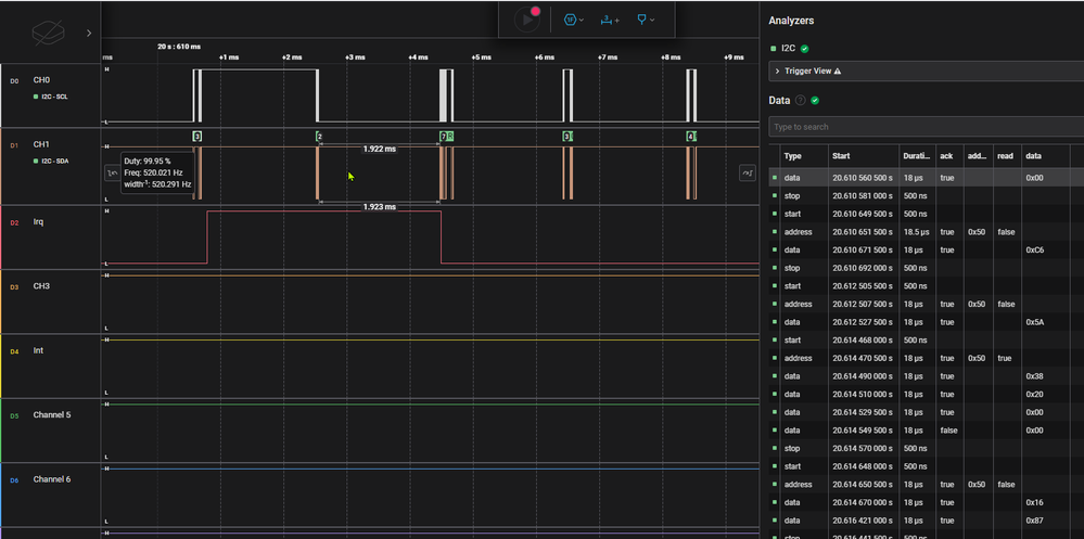

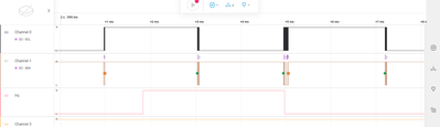

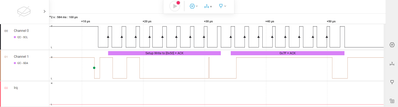

I enabled the ST25R_SELFTEST & ST25R_SELFTEST_TIMER and debug the code , st25r3916Initialize() returns RFAL_ERR_NONE.
I captured the Logic analyzer data , i have attached the file, PFA.

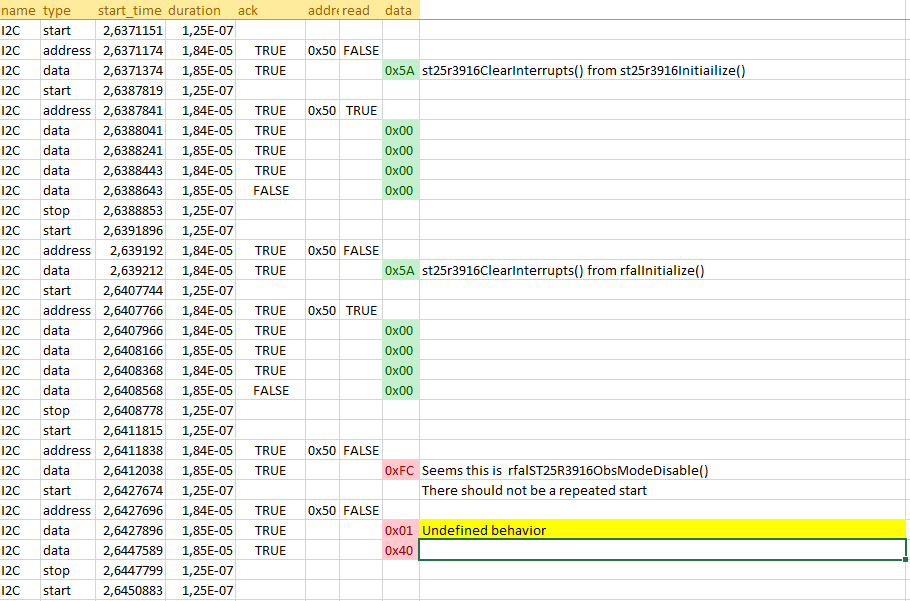

Hi BS,
Hi BS,
thanks, Saleae trace is welcome. In a future step it would also be useful if you share not only the initialization but also the complete failed attempts to read a UID.
In any case I analyzed based on your Excel and I found an unexpected behavior as repeated Start is performed where it shouldn't:
Please fix these repated starts and maybe it starts working. What I am seeing as well that your I2C driver has huge delays - this will for sure also lead to one problem or the other.
BR, Ulysses

Hi BS,
as feared before: With such slow I2C more issues will be ahead:
You are seeing here:
  1. C6 command: Send NFC-A REQA
  2. 5A - 38 ..., the 38 denoting that data has been received (I_rxs, I_rxe, I_txe)
  3. 16 - 87 : Clearing of interrupts, software does that if no interrupts have been received within I think 1ms
So the actual data is disregarded by software due to slow IRQ handling. Above I find almost  2ms between sending the 5A byes until starting to receive.
I think you need have few fronts to work: Assure that interrupts are handled before the timers expire. And overall I recommend to remove those delays in the I2C.
Also I consider it likely that you can remove some technologies if you only want to read normal cards: AP2P and maybe also ST25TB.
BR, Ulysses
