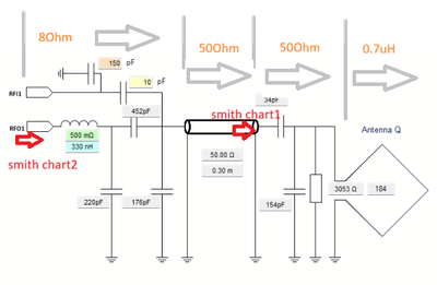

I'm using an ST25R3911B driving a remote PCB antenna via a 0.3m 50Ω coaxial cable in single-ended mode (RFO1). The antenna is a 2-turn square loop, 70×70mm outer dimension, 1.4mm trace width, 0.7mm spacing, calculated inductance ~735nH.
The chip drives two antennas switched alternately — RFO1 to the remote antenna via coax, RFO2 to a local antenna. Both antennas show identical poor range (~10mm), so the problem is not specific to the coax path.

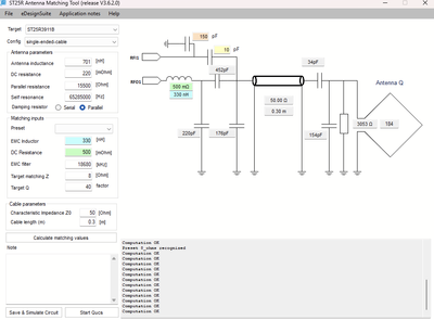

Hardware — Reader PCB Matching Network
Designed using the ST25R Antenna Matching Tool V3.6.2 with these parameters:
  • Target: ST25R3911B
  • Config: single-ended-cable
  • Antenna inductance: 701 nH
  • Target matching Z: 8 Ω
  • Target Q: 40
  • Cable length: 0.3 m
Reader-side components (confirmed populated):
  • EMC inductor: 330nH, 160mΩ DCR
  • First shunt: 220pF C0G
  • Series cap: 176pF C0G
  • Middle shunt: 452pF C0G
  • RFI1 divider: 10pF / 150pF C0G
  • SMA shunt: 154pF C0G
Hardware — Antenna PCB
Topology: Coax SMA → C1 (series) → node → C2 (parallel to GND) + R1 (parallel to GND) + Antenna loop
Current tuned values (arrived at empirically via VNA):
  • C1 = 47pF C0G
  • C2 = 110pF C0G
  • R1 = 1kΩ
  • All caps confirmed C0G/NP0 (Kyocera KGM series)

VNA Results
After extensive iterative tuning, best result achieved:
  • SWR: 1.04 at the reader SMA (measuring through 0.3m cable)
  • S11: -35dB
  • Resonance: ~13.85 MHz (slightly high, 13.56 MHz target)
  • Impedance: ~49Ω — essentially perfect 50Ω match
Smith chart shows clean resonance loop passing through center.

Travis Palmer

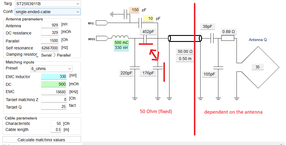

Hello qwdwdwwq,
I think you have mixed up some components of the matching network.
Do not seem to be correct.
Please see attached the proposed matching network in the antenna matching tool:
The left side of the sma cable is fixed since it matches 8Ohm to 50Ohm. The right side of the matching network is dependent on the antenna parameter. It matches the antenna (inductance) to 50Ohm.
q1: Not sure about q-multiplication, but yes, in general the antenna voltage is 5-15 times higher than the RFO output.
q2: Please have a look at the single ended application note (AN5592)
q3: Yes, this is why per default a capacitive voltage divider of 10:150 is proposed.
q4: I think you have wrong matching values applied. Can you please share a smith chart of your antenna matching?
BR Travis

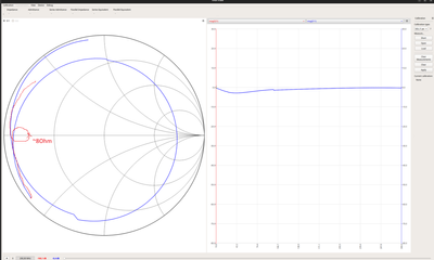

Thanks for help,
Here is the last smith chart, measured with the cable:
And also last tool output, im not sure about those and will double check if the actual soldered caps match this:

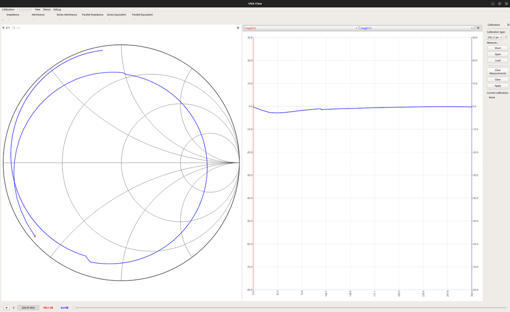

Hello qwdwdwwq,
Many thanks for sharing the smith chart measurement (smith chart1).
It confirms that your antenna is correctly matched to 50Ohm.
Can you also share the smith chart of the complete matching (smith chart 2)?
BR Travis

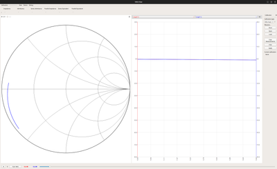

I took a screenshot of smith chart 2
Travis Palmer
Hi again,
unfortunately the 13.56MHz marker is missing.
Maybe can you also increase the span? There is no resonance visible.
BR Travis

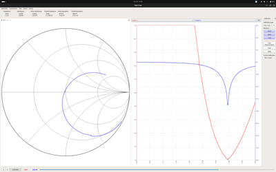

Sorry, I increased the span to 250Mhz
Your smith chart tells me, that the series and parallel cap does not fit.
The circle should look like this: (red curve)
BR Travis
Do you have some guidance on how to tune this? its way off from what the tool calculated
