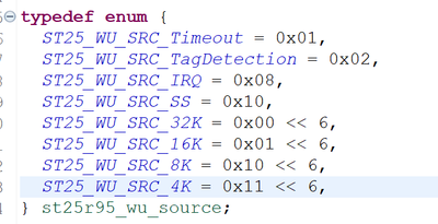

if I am not wrong, the wake source in your application is only tag detection (0x02) and therefore a pulse on IRQ_IN will not exit from Idle mode.
If your application has to support wake up by both IRQ_IN pulse and tag detection, make sure to have WU source = 0x0A (low pulse on IRQ_IN | tag detection).

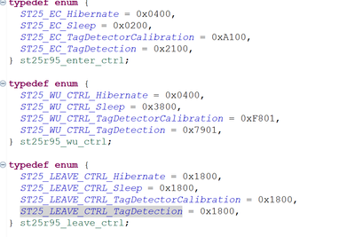

The wakeup control parameter does not have the value recommended in the ST25R95 datasheet (0x3801):

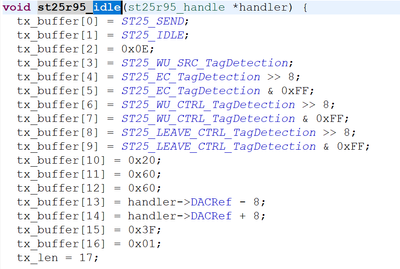

Can you share the dump of the Idle command sent by your application?

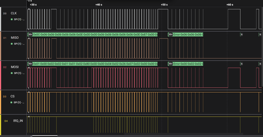

Here is our logic analyzer output. You can see constant reads from the reader, and resets of the PCB around 34, 50, and 60 seconds. You can see that after the reset at 50, it stops trying to search for tags, and after that point, it is unable to reset properly or communicate over SPI.
I've also included a screenshot of our idle bytes.
As I can read Salae files, feel free to send me the trace (make sure to include both IRQ_IN and IRQ_OUT)
