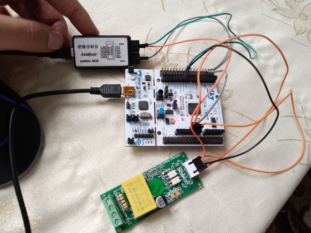

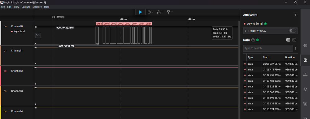

I'm currently facing an issue with my custom USART driver for communicating with the PZEM-004T module. I've successfully developed and tested this driver, and it works perfectly with other devices like the ESP32, where I receive responses without any problems. However, when I attempt to communicate with the PZEM-004T, the data sent appears correctly on the logic analyzer, but I receive no response from the slave, i also tried sending the command from pc using Tera Term 5 but same. I've verified that I’m using the correct settings: a baud rate of 9600, 8 data bits, 1 stop bit, and no parity. Additionally, I've checked the Special Function Registers (SFRs) to ensure everything is set up correctly. I've also tried changing the slave address and modifying the Modbus command, but none of these adjustments have yielded any results. Any guidance or suggestions on how to troubleshoot this issue would be greatly appreciated.

I finally found a solution for communicating with the PZEM004T v3.0 module using the STM32F401xx and a custom UART driver I developed.
One important detail that stumped me for a while: to get the RX data from the sensor, you must power the PZEM004T with 220V AC. Without it, the module won't start sending data. So make sure it's properly powered before attempting any communication!

@MahjoubHafyen wrote:it works perfectly with other devices like the ESP32, where I receive responses without any problems. However, when I attempt to communicate with the PZEM-004T, the data sent appears correctly on the logic analyzer, but I receive no response from the slave
So have you carefully compared some ESP32 logic analyser traces with some STM32 logic analyser traces?
Also try using an oscilloscope - that might show up any "analogue" oddities not visible on a logic analyser.
