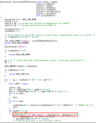

what you see on the SPI trace is the manchester stream between the reader and the tag. This stream of data in then decoded by the FW.
You can decode it by porting rfal_iso1693_2.c in your environment.

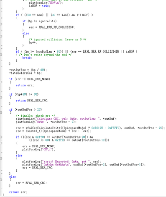

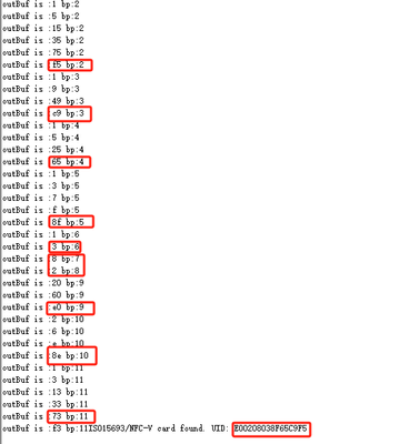

The other night, you answered my question in the ST community and mentioned that I could use 'rfal_iso15693_2.h'. I did use it, but it seems I still can't decode.
This is the serial information printed out from my function calls in rfal_iso15693_2.h.
The function does not decode this data into a UID.
this serial log is intended to display debug information such as current bytes to be decoded from the input buffer while processing the manchester frame. The decoded result is inside the output buffer (outBuf). I can see from your log the final "OK" from line 392 that proves that the decode fonction returns RFAL_ERR_NONE and that the outBuf contains the decoded data.
Please note that ISO15693 data are transmitted LSByte first and therefore for an UID= E0 02 08 03 8F 65 C9 F5, the buffer will contain F5 C9 65 up to E0.

Hi Brian,
First of all, thank you very much for solving my problem. I did indeed see the decoded UID in the ‘outbuff’.
However, I would like to know what the 0th and 1st bits, as well as the 10th and 11th bits, refer to.
I'm guessing that the 0th and 1st bits refer to SOF, and the 10th and 11th bits refer to EOF.
So, that means the 0th and 1st bits, as well as the 10th and 11th bits, are the same for all tags in the same series, right?

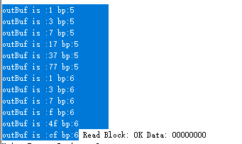

Secondly, I have another question regarding the blocks on the TAG.
This is the decoded data.
So, how can I find that the data in the block is 00000000?
I am not sure to understand the first question about 0th and 1st bits and SOF/EOF. Each frame is delimited by a SOF and a EOF. When using 1 subcarrier in ISO15693, the SOF consists of 3 times a 18.88µs unmodulated time followed by 3 times 8 pulses followed by a 18.88µs unmodulated time + 8 pulses. This is received as 1 1 1 0 1 and seen as 17h in the FIFO. SOF and EOF are specified by the ISO15693-2. Tags compliant with this standard use this framing.
For the second question, make sure to print the outBuf once the processing has been completed. The various bytes of the outBuf are modified on the fly while decoding the manchester stream.  Also, the response to a READ SINGLE BLOCK starts with 8-bits response flags followed by the block of data (usually 4 bytes) followed by a 2-bytes CRC. The data in the outBuf are 00(flags) 00000000(4-bytes block) 77CF(CRC).
