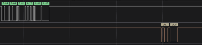

uint8_t commandDETECT[] = {0x04, 0x04, 0x01, 0x26, 0x01, 00};
When there is no tag placed near the CR95HF we get the 0x87 response as expected.

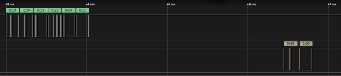

But when we place the ST25DV discovery tag next to the antenna we should expect a response with UID.
But all we get is response 0x88. This is a SOF error. What could be the cause of this error?

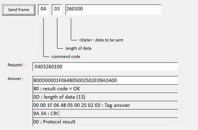

the command set supported by the tag is described in the tag datasheet. Typically a Read Single Block (20h) command can be used to read a block. A Read Multiple Blocks (23h) command can also be used to read several consecutive blocks.
Those commands can be sent to the tag through a CR95HF sendReceive (04h) command:
0x04(sendReceived) 0x03(length) 0x02(request_flags) 0x20 (read single block command) 0x00 (block #00)
Make sure to implement some retry mechanism is case of transmission error.
I would suggest to prototype the various commands you will send thanks to the STSW-95HF001 PC GUI connected to the (unmodified) MB1054 board.

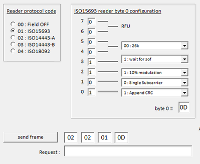

The Inventory command ("commandDETECT") is incorrect. It should be  0x04 0x03 0x26 0x01 0x00:
I would also suggest to change the protocolSelect command in the following way:
  • wait for SoF rather that wait for a fixed delay
  • use 10% modulation rather than 100%
Rgds
BT
Hi Brian,
Thank you for your answer. We now receive the UID as expected.
