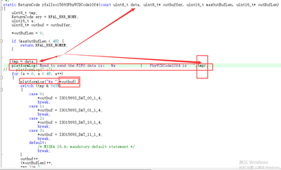

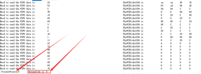

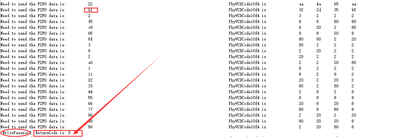

Next I try to print out the FIFO data as follows:
1.The GetRandomNumber function is normal
2.PresentPassword's ReturnCode is incorrect
3.WritePassword's ReturnCode is incorrect ,too.
so why is the value of ReturnCode 5?
And why am I still calling the api function of the demo? but invalid request or requested function can't be executed at the moment.
So, in order to encrypt the block, what exactly should I do?!     What configurations do I need to set up first?!
Supplementary instruction,
my print function is as follows

Hi Rance
If you want to set a password for the user memory area on the card.
You need to follow these steps
1.Get 2 bytes Random Number
2.Make the password and Random Number XOR.
3.Use the Present Password function to enter secure session mode.
4.Start writing the password that you want
Notice:
The initial password is  0x00
