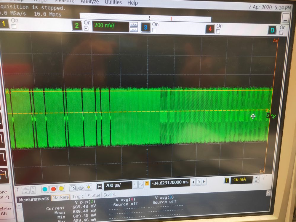

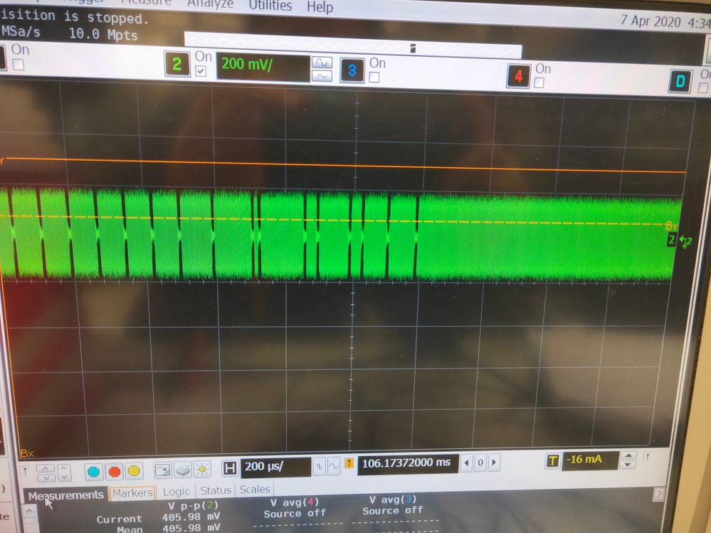

Recently I use the ST25R3916 board(1.7W) and try to find the power or sensitivity limited issue. I use the pick-up coil connected to the oscilloscope to test ,
Results as below:
Tag can be read area:(two different waveform)
When I increase the distance to move tag out of the detecting area, results as below: (one waveform)
From the results,is it the reader's power limited leads the communication stopped ?
Thanks!
​Hello Sky,
Since the tag does not respond anymore, it is very likely that the tag has not enough power to operate.
Therefore it is power limited.
