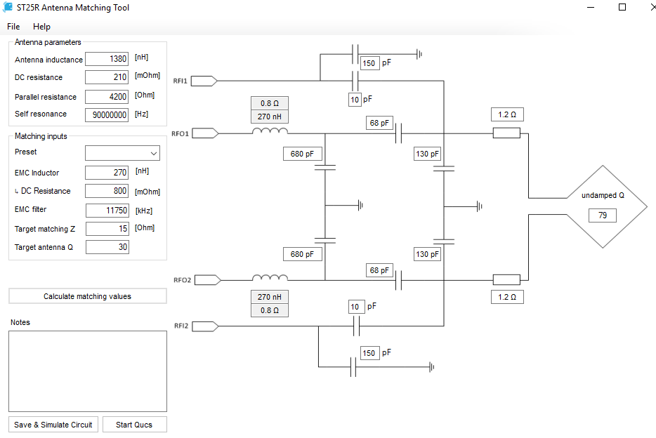

Thanks a lot for your reply. This is some inputs and test set up:
Could you point out whether there is any mistake above?

all your inputs in theST25R Antenna Matching Tool look valid.

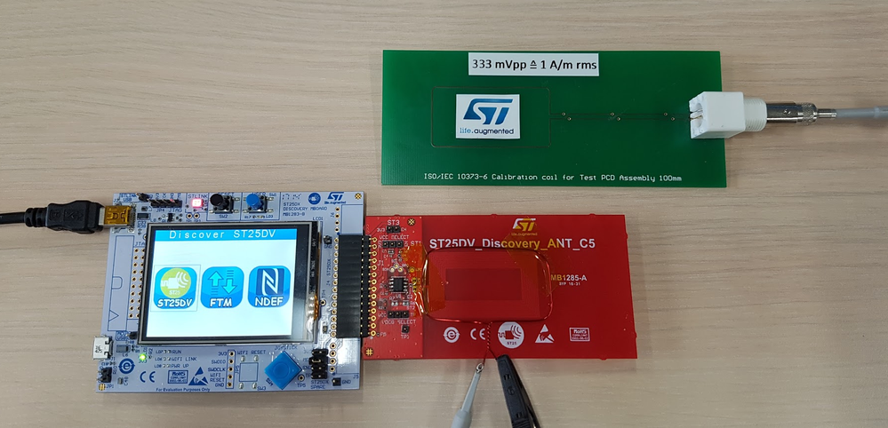

1.) To do so, you should put a pick-up coil (either a self-made wire-wound or ISO calibration
coil) on the tag. The tags and pick-up coils antenna should have nearly the same geometry to sense exactly the field the tag sees.
2.) Connect the pick-up coil to the oscilloscope using a high impedance probe.
3.) Put the tag+pick-up coil in an area where the tag can be read reliably. Using the ISO15693 tab's Inventory button you should be able to see the readers request
and the cards response.
4.) Move the tag+pick-up coil slowly out of the operating area. hold the position, once the Gui does not display the tag anymore.
5.) There are now two possibilities, why the communication stopped working:
A.) Power limited: The tag's answer disappeared or is very different (shorter) as before. The tag has not enough power to reply.
B.) Sensitivity limited: The tag shows still the same response, but the reader is not able receive the signal.

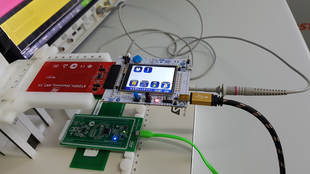

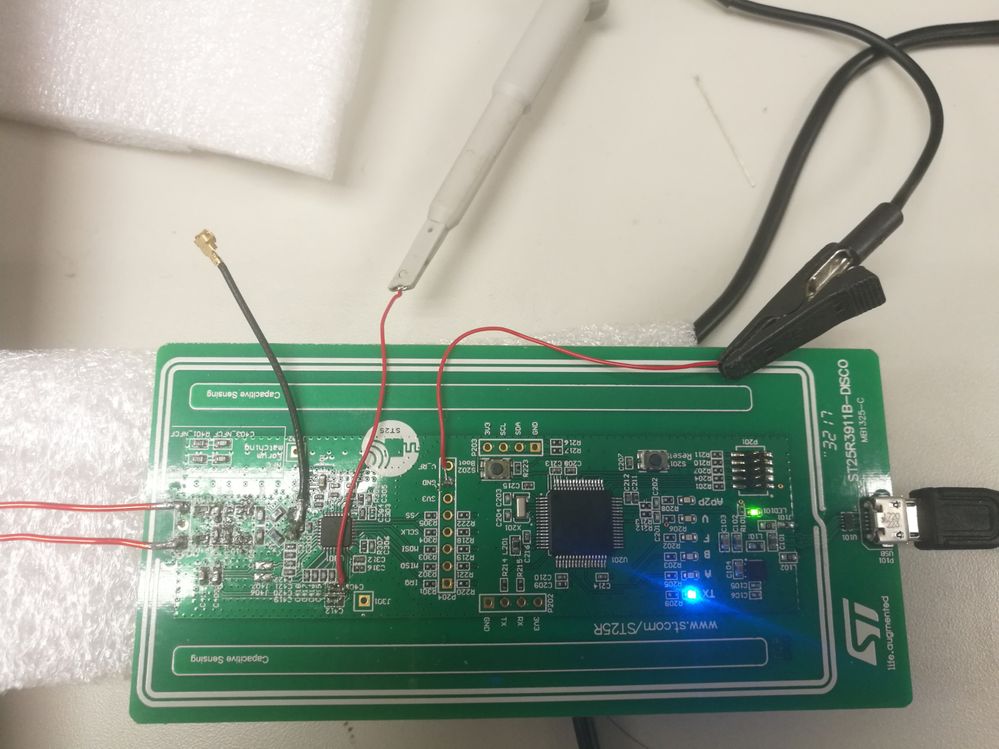

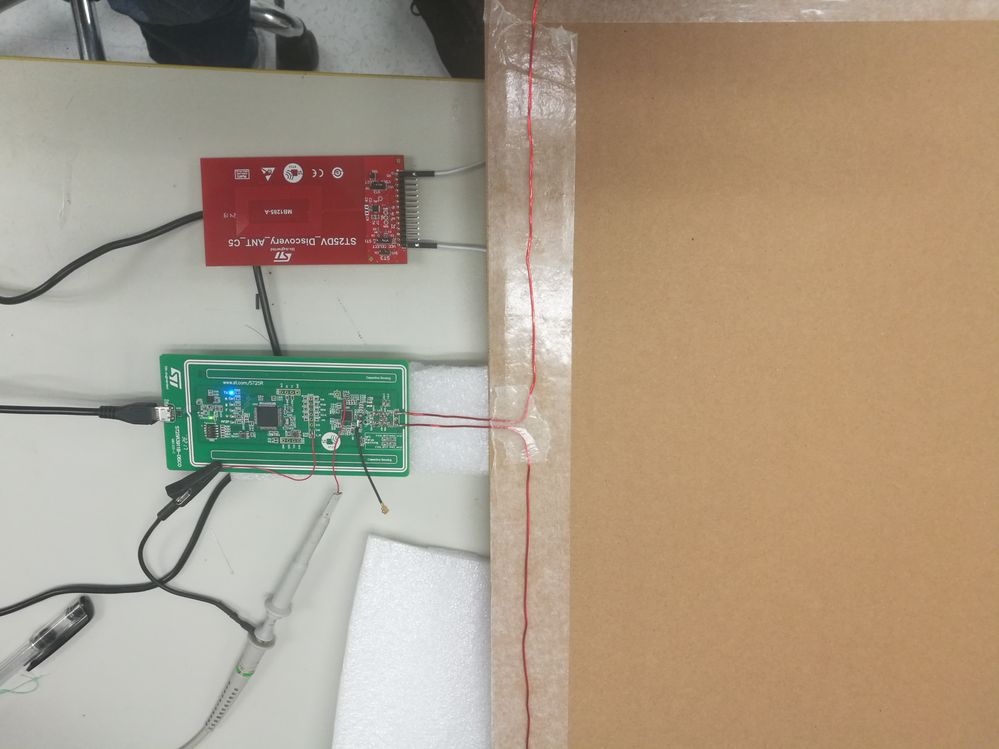

I usually use two pick up coils. One is close to the reader and used for triggering my scope, the second one is used to pick up the cards response.
You can either use a self made pick up coil (red wire tapped to the ST25DV_Discovery_ANT_C5 PCB directly) or an ISO Calibration coil (green PCB).
Both methods should use a high impedance probe to connect to the scope.
This is my lab setup for such investigations:

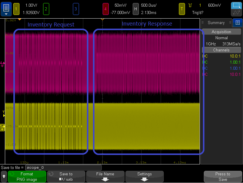

The yellow channel is recorded via the pick up coil close to the ST25R3911B-DISCO board. You can clearly see the inventory request command sent by the reader. The inventory response is already very small and cannot be seen with bare eye anymore. Still the reader can decode the response.
The red channel shows the signal recorded very closely to the tag. We can therefore clearly see the request sent by the reader and also the response sent by the ST25DV_Discovery_ANT_C5 tag. It shows the H-Field close to the tag. 0690X00000AtEyKQAV.png
If you now increase the distance between reader and tag, either the reader stops seeing the tag (sensitivity limited) or the tag stops responding (power limited).
On your setup, the reader antenna is very big and the tag antenna is very small. This means, there is already a bad coupling between the two antennas. The coupling influence both factors:
The power transferred from reader to tag and the load modulation amplitude (LMA) the tag can do.
In your case, I would recommend to increase the coupling by increasing the tag antenna size. Using a ID1 size antenna should already boost your results.

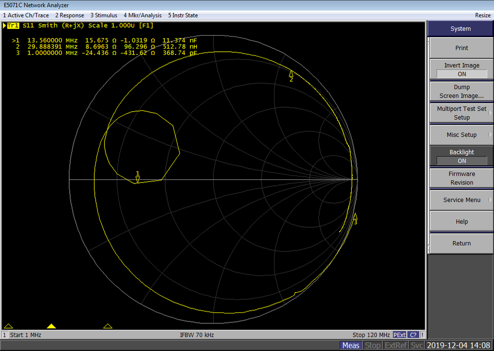

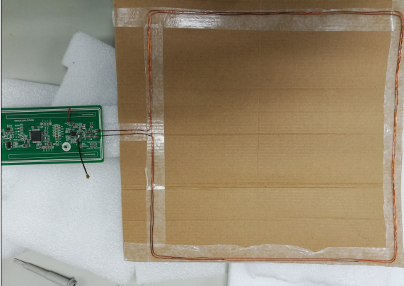

I have tried the smaller coil 25*25cm(2 turns) with the smith chart and change the received settings as below:0690X00000AtGcLQAV.png0690X00000AtGaZQAV.png0690X00000AtGaPQAV.png
Now the maximum reading distance is 25cm, do you have any other suggestions for improve the reading distance, such as add power... or this is the limited distance for my case, actually the tag coil size can't be increased more...
Another question is the coaxial cable connected to VNA, did i need disconnect the circuit behind?
Thanks.

Still the question is, if the tag stops replaying to the reader command, or if the reader does not see the tags response.
If the tag stops replaying, we can bypass the internal regulator and decrease the matching impedance to 6-8 Ohm.
If the reader does not see the response anymore, we need to look at the internal receiver signals to optimize the settings.
Do you have the trim pins connected? At 15 Ohm matching impedance and a high Q-factor it is most likely that the limit of 20V on the trim pins is exceeded.
The result might be, that the ESD protection is getting active and reduces the voltage / power on the antenna.
Your matching and VNA measurement looks perfect.
br Travis

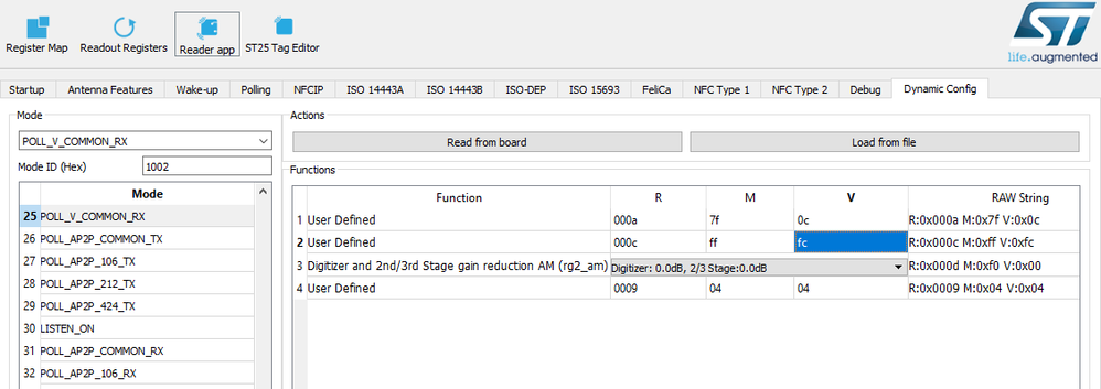

And I tuned the matching impedance to 7Ω and connected pin9 to VDD(J303 with 0Ω),the distance no improve,
could you tell me how to optimize the settings of internal receiver signals?

Yes i am confident that this can be achieved. Likely due to the bad coupling between reader antenna and tag antenna additional circuitry (amplifier, filter) might be required.
Internal receiver signals:
You need to connect to P301 (CSO) and P302 (CSI) on the bottom side of the board. There is a footprint for UFL connectors foreseen where a UFL to BNC or SMA cable could be plugged. You can also directly solder a cable to the pads. To capture a good signal, i recommend to remove / cut the traces leading to the capacitive patches (they could pick up some field).
You should then use a high impedance probe to feed the signals into the oscilloscope.
Referring to chapter "1.2.15 Test access" of the datasheet DS11793 - Rev 5:
By setting the registers as described in this section, you can e.g. output the analog signal of the AM channel and see how the digitizer decodes it.
several other combinations are possible as mentioned in Table 13.

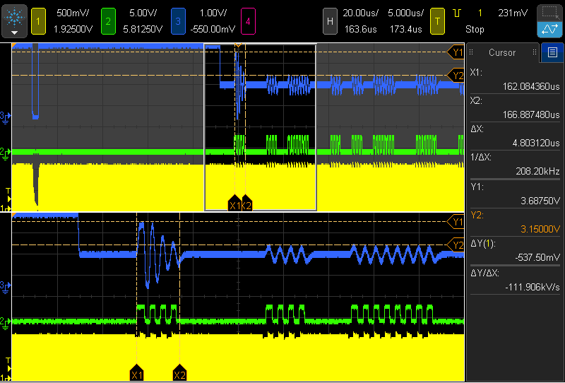

Below you can see a Type A response showing:
Yellow: H-Field
Blue: Analog output of AM channel (before digitizer)
Green: Digital output of AM channel (after digitizer)
The screenshot shows a quite strong signal. After the first sub carrier pulses the AGC reduced the signal to a optimum level.
You can now alter filter and gain settings and instantly see their impact.
