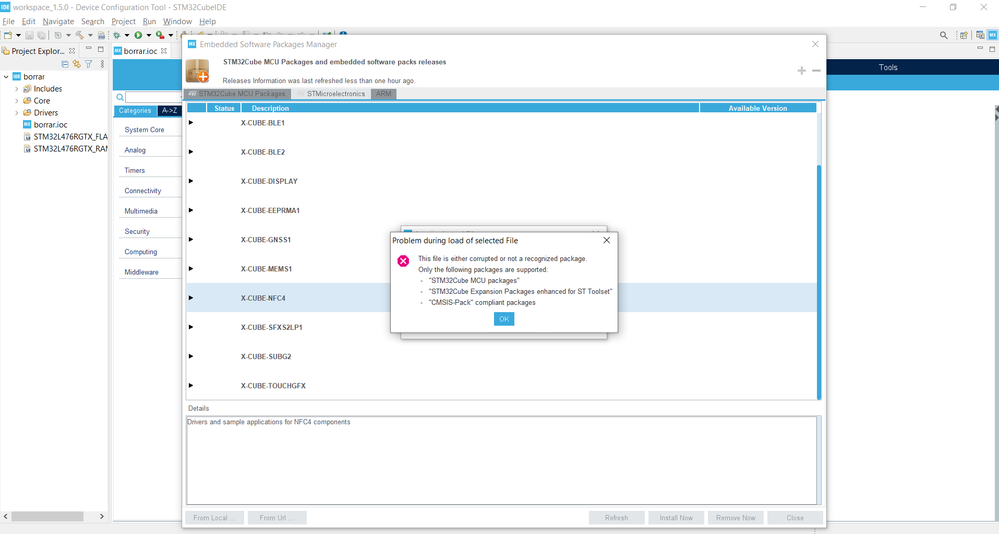

Is really STM32CubeIDE or STM32CubeMX embedding this software package?
The link you provide is the expansion pack, which was already out there (older versions though)
We could import examples of NFC into our workspace but the IDE and the MX does not have the X-CUBE-NFC6 software package and Import "From local" fails.
