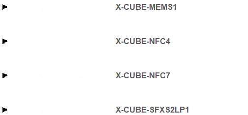

Gfang.2
Thank you, but I didn't find X-CUBE-NFC5 in it.
