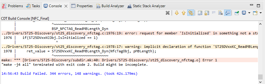

Hey, Can you please help me with using ST25DV64KC board. With stm32L476VGT6 core M4 processor.
I want to do NFC communication. I couldn't find anything on the internet or youtube about how to program it.
Somewhere, i read that we have to download the firmware for our board. And it contains the source code..
I downloaded the firmware for my Board from the ST community website. But when I run it it gives me errors. I am trying to resolve these erros from two to three days. But they are not completely removed. The software I am using is STM32 Cube IDE. I want to ask the following questions:
1) Is the firmware code the only way to do NFC Communication? And am I doing something wrong?
2) The IDE that I am using is Stm32 Cube IDE. Does the firmware code supports this? Or it is written for Keil?
3) Do the package contains file that should be removed in order to run it in Stm32 Cube ide.
I will be grateful if you can help me with my questions. Thank you very much.

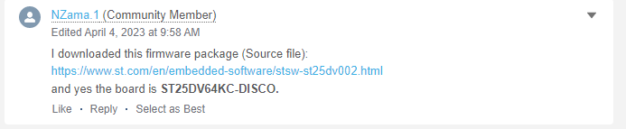

    I downloaded this firmware package (Source file):
    https://www.st.com/en/embedded-software/stsw-st25dv002.html
    and yes the board is ST25DV64KC-DISCO.

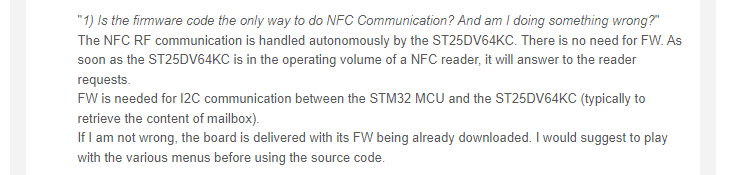

    "1) Is the firmware code the only way to do NFC Communication? And am I doing something wrong?"
    The NFC RF communication is handled autonomously by the ST25DV64KC. There is no need for FW. As soon as the ST25DV64KC is in the operating volume of a NFC reader, it will answer to the reader requests.
    FW is needed for I2C communication between the STM32 MCU and the ST25DV64KC (typically to retrieve the content of mailbox).
    If I am not wrong, the board is delivered with its FW being already downloaded. I would suggest to play with the various menus before using the source code.

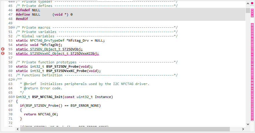

    make sure your include path is correct. You can retrieve the include path inside the Keil µVision uvprojx file (see <IncludePath> in the Project.uvprojx file). Also make sure to have the proper defines (see <Define> in the Project.uvprojx file).

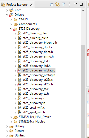

    Here attached you will find the project files for STM32CubeIDE to help you working with ST25DV64KC-DISCO and STM32CubeIDE.
    I used references to source code instead of direct source code in the project explorer, so you need to copy the folder from the zip file in the source code of the ST25DV64KC-DISCO to Projects\ST25DV-Discovery\Demonstrations\ST25DVDemo\ to have correct references. Include files are set in the project properties menu in C/C++ Build -> Settings -> Tool Settings -> MCU GCC Compiler -> include paths. Preprocessor symbols are also defined.
    I hope this can help you.

    Hi, Thankyou what you did. But unfortunately I got this when I pasted your file here Projects\ST25DV-Discovery\Demonstrations\ST25DVDemo\
    I just change the name of your MX file from NFC_Final_Working to Final_NFC_Working so I could remove the error . But i could'nt get that whether I did what you asked me to do or not? Have I placed the files in the correct place? Can you clear me the complete folder paths I mean complete folder that worked for you? Not just the inner project file? Thank you. Best Regards.

    Hi @NZama.1​,
    I didn't update the IOC file for this project so that's why you got the error opening this file.
    Just copy into the folder as you did (Projects\ST25DV-Discovery\Demonstrations\ST25DVDemo\NFC_Final_Working). And you should be able to compile the project, if not give feedback on errors you get.
    You may have some warning during compilation because keil and STM32CubeIDE doesn't use same compiler but compilation and running should be ok (it is on my side).
