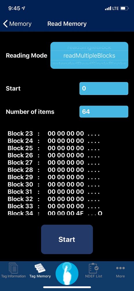

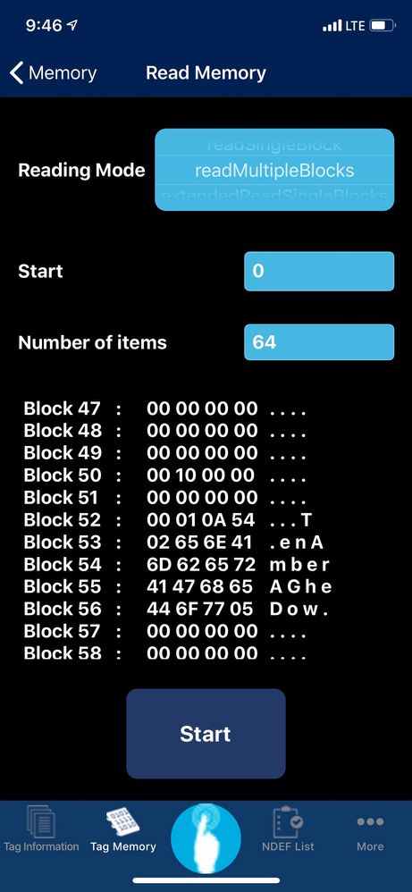

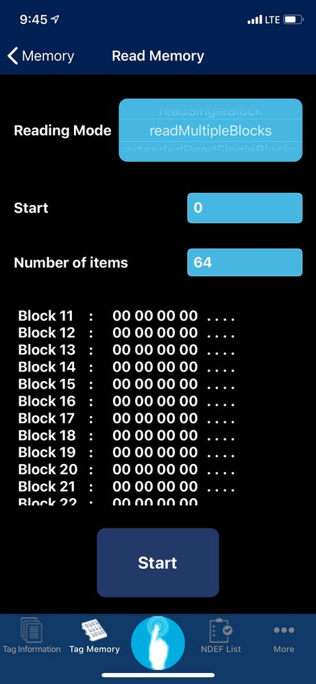

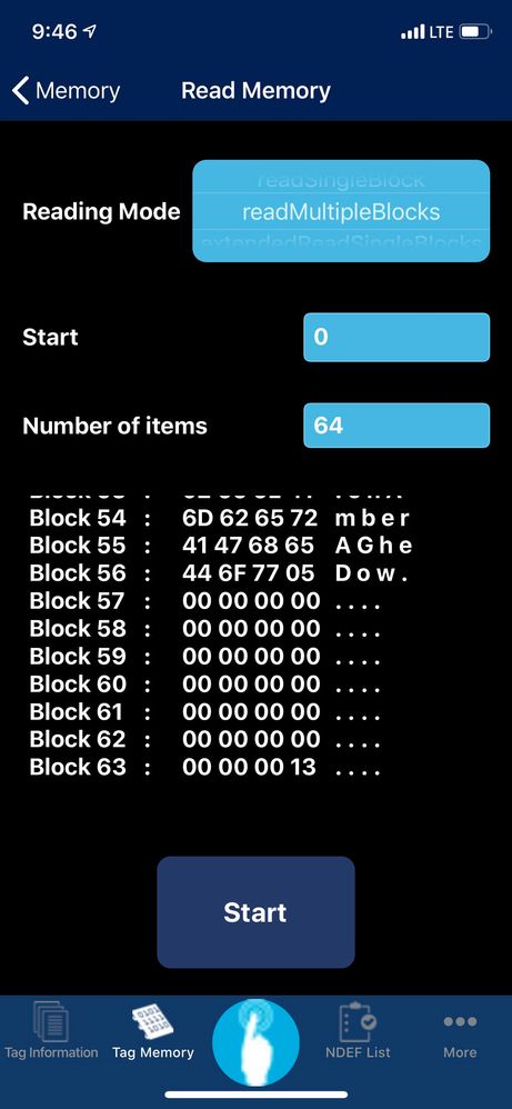

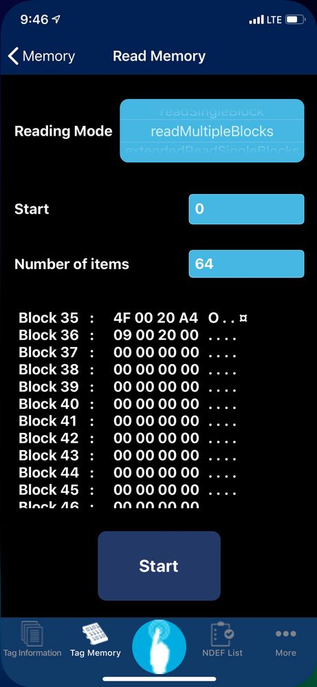

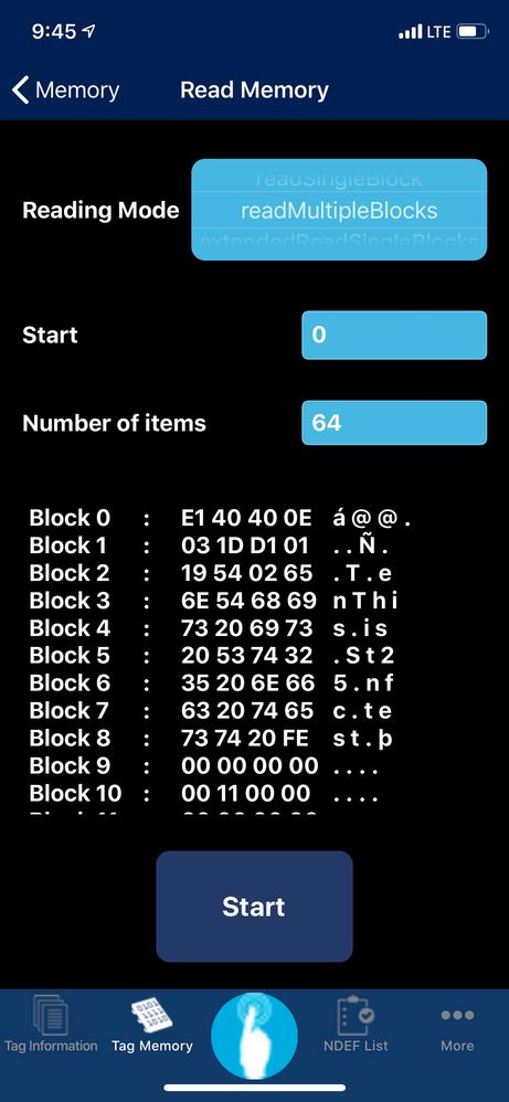

I have ported the ST25DV NFC tag driver from STM SDK for TI's CC2650 SoC. Currently, I am able to successfully read and write TEXT data to the tag via I2C. However, when I read the data out from the tag using the STM's NFC Tap APP, I see that the data gets written from BLOCK 53 onwards in the EEPROM instead of the beginning of the block as shown below:
Due to this, when I read the NDEF data from the APP, it does not show me the data that I have written. All the configurations are exactly as the driver provided by the STM. Am I missing something or doing wrong? What can be the solution to this?

I'm working on iOS NFC Tap application. Please, could you send us screenshots of ReadMemory from Block0 to block60 ? It would help us to better understand.
Do you get same behavior with Android App ? I would like to be sure that issue does not come from reader in first.
Thx and br,
Hi Victor,
Thanks for your response. I think the issue is not with the reader but with my i2c write function for the CC2650. I connected the tag with Arduino and there things work as expected. However, I am still sending you the screenshots from the iOS reader APP if it helps.
