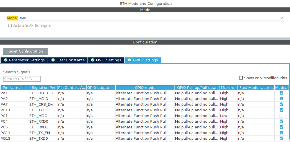

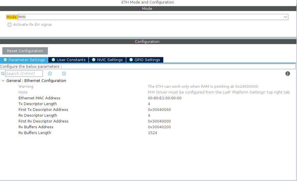

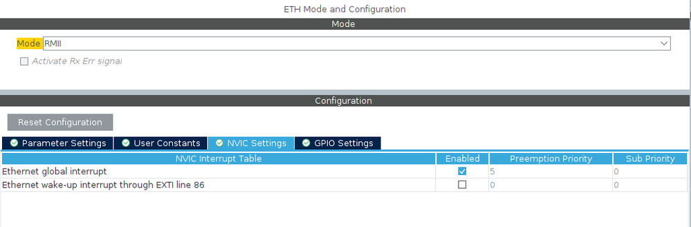

Hello Jocelyn,
Thank you for your answer and your help.
If I remove Ethernet connectivity it is working ! Same thing, if I remove MPU protection from app_sfu.h. It seems then there is a conflict between Ethernet connectivity and MPU protection.
Here my Ethernet connectivity configuration:
0693W000008z4lHQAQ.png0693W000008z51cQAA.pngHave you any idea of the reason of the conflict ? Thank you.
Regards
