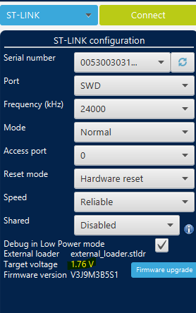

I work on a custom board based on stm32f446x MCU. I'm having trouble when writing to external flash using STM32CubeProgrammer. After powering on the board, I can connect and read the external memory correctly. However, when I try to write, the operation fails, and all memory values change to 0x555555. Deconnect/Reconnect from StProgrammer doesn't fix it, but after a power cycle, the correct data is readable again until I attempt another write.

I also noticed that the target voltage (1.76V) after having the issue is lower than expected.
Has anyone experienced this or know what might be causing it? Any advice would be appreciated!

If voltage droops when you try to program flash, probably the power supply for the board is insufficient, or there is some other design error. Can you share the schematic?
‎2024-08-26 7:15 AM - edited ‎2024-08-26 7:34 AM
Thank you for your reply.
No, the voltage does not drop only during the writing operation. On the CubeProgrammer interface, I can see the target voltage after powering on the board and before connecting; it shows a value of 1.76V.
Let me provide more context: It was functioning correctly with an older version of the external loader. The issue started after creating and testing with a new QSPI loader created using STM32CubeIDE to improve certain aspects. However, even after reverting to the previous loader, the problem persists.
I suspect that some default configurations in STM32CubeIDE (example: forgetting to comment out protection settings or ...) during the creation of the new loader might have introduced write protection or caused a hardware issue leading to the lower-than-expected voltage.
Could this be the case?

If voltage drops *at all*, or otherwise not at its intended level, that's not something the software is going to be able to fix. If 1.76V is low, what is it supposed to be? Likely that's the source of your issues.
