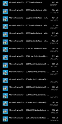

How about other Microsoft Visual C++, here is my pc install, please check if you miss someone.
Please install Microsoft Visual C++ 2010 version first
@sjones
We have confirmed this version GUI is dependent on “Microsoft Visual C++ 2010 X86 Redistributable Package” .
