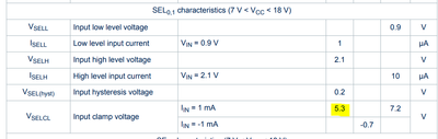

What are max operating input voltage of vn7000ay logic pins (e.g. SEn, IN, SEL)?
jsmith
I can't find the max operating voltages of the logic pins.  Is it same as Vcc?  Thanks.
1 REPLY 1
5V. Above that they're going to start clamping the voltage. See Table 9 in the datasheet.
