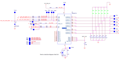

I am trying to send first command from the MCU (s32k312 -NXP).
I am able to send but I am getting SPI response like
And afterwards, no matter which SPI commands send, it always sends same response from the chip i.e. 0x610000
As per the Datasheet, says it is FailSafe Mode and getting SPI Error.
I did all the combinations in SPI communication, but it is not getting clear this SPI response.
Again, Please post logic analyser screenshots for people to check.

Have you looked at the SPI lines using an oscilloscope and/or an analyser?
You need to do this first to confirm that your MCU is actually sending the correct signals to the VN9E30F, and that the correct signals are coming back to your MCU.
yes of course, I verified on Oscilloscope/Picoscope. It is showing same as i have shown on SW Snapshot.
Unfortunately, that can't be taken for granted here!
If that's not the answer, why did you mark my post as the solution?  Instructions here to unmark it if your issue is not solved.
Also your schematic.

chintan-tvs
Note:
1. I am using GPIO Pin for PWM,  it is set by default,
2. Rest of the GPIO PINs i.e. DI0,1 are set to Low/Clear,
