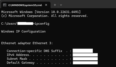

To run the example in the hotspot, you first need to configure the STM32 to be on the same network as your computer. To do this, follow these steps:
  1. Press Windows Key + R.
  2. Type cmd and press Enter.
  3. Type the command ipconfig.
  4. Look for the following configuration:
    • IPv4 Address
    • Subnet Mask
    • Default Gateway
  5. In your STM32 project, open the lwip.c file and set the same Default Gateway and Subnet Mask, but use a different IPv4 address by changing the last number.
  6. Recompile the project and flash it. If all goes well, you should be able to ping the board.

  1. In your STM32 project, open the lwip.c file and set the same Default Gateway and Subnet Mask, but use a different IPv4 address by changing the last number.
And ensure that last number to be unique in the network: not used by another device on the network.
